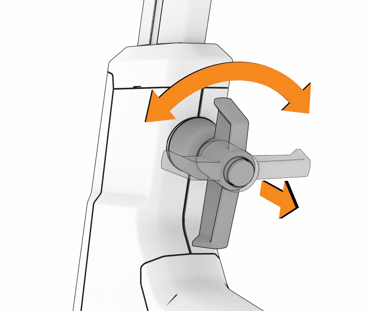

Using the Adjustment Handle
The Tacx NEO Bike includes adjustment handles that can be installed to aid in quick geometry adjustments. If multiple riders will use the trainer, Tacx recommends installing the handles for easy adjustments. The handles are packaged in the assembly kit with the screws and washers. If you are the only rider that will use the trainer and you do not make geometry or posture adjustments, you can use the set screws and a hex key. The handles can be aligned parallel to the frame or rail after tightening by pulling out to disengage the handle, and twisting to bring it in line with the frame or rail.
NEO Bike Adjustment Handle
