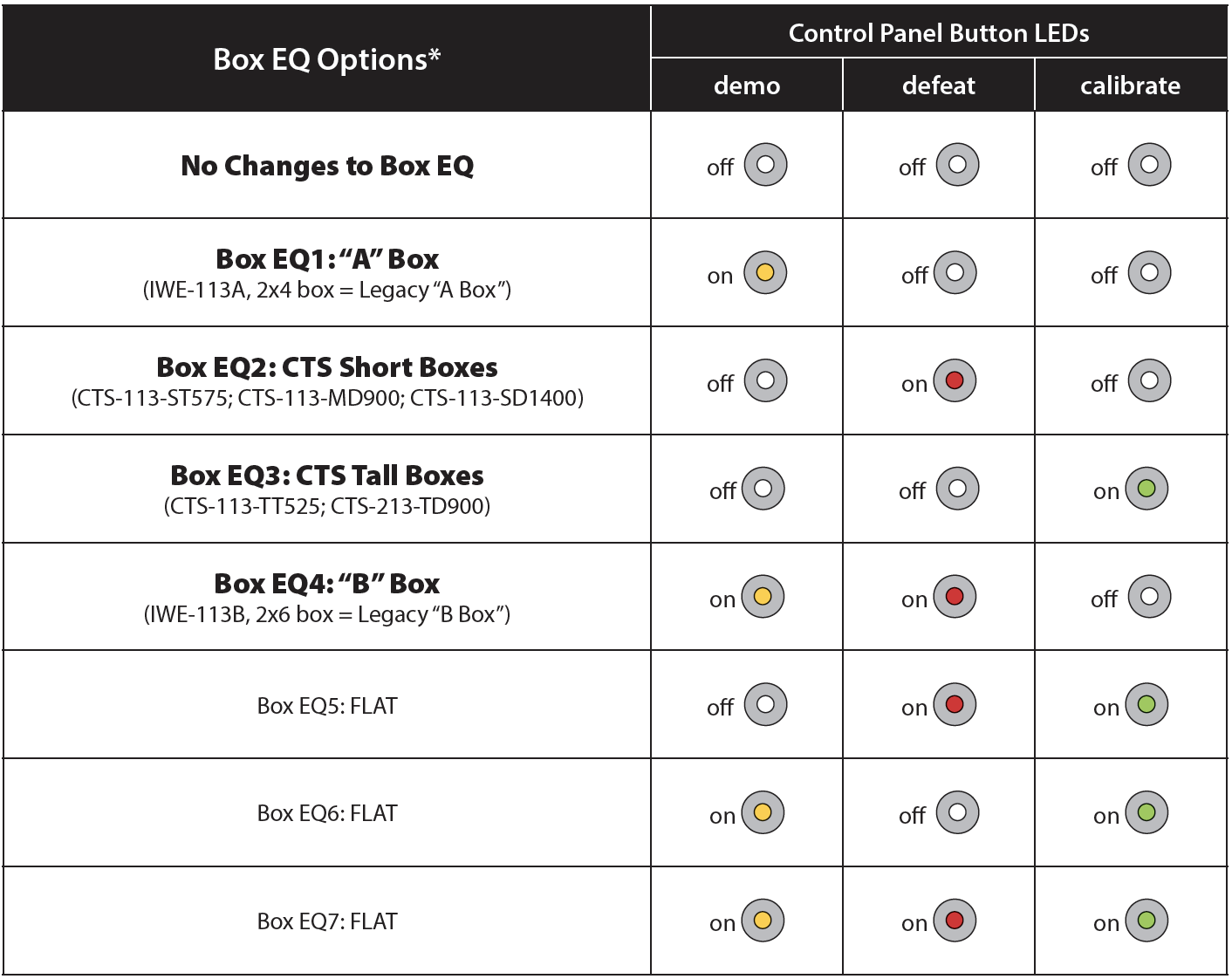

5b. To change the box EQ, press the demo, defeat and calibrate
buttons to match the desired LED pattern in the table below,
then turn the Power switch on to save and exit programming.
