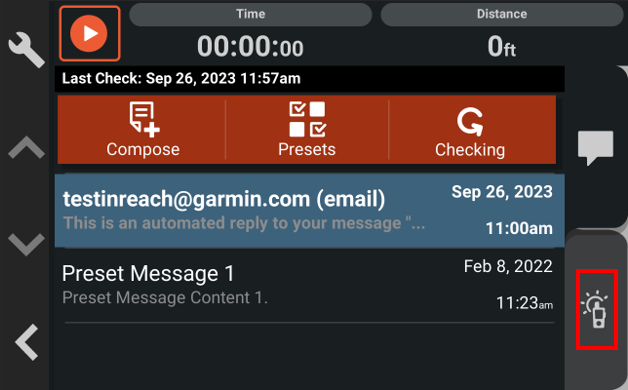

  1. Select inReach from the home screen.
  2. Select the tab in the bottom right to get to inReach Weather

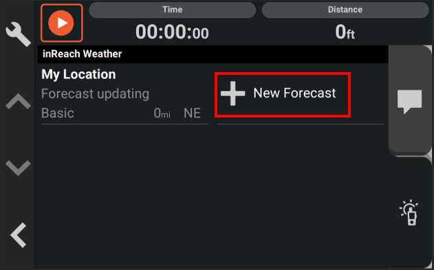

  3. Select New Forecast.
    OPTIONAL

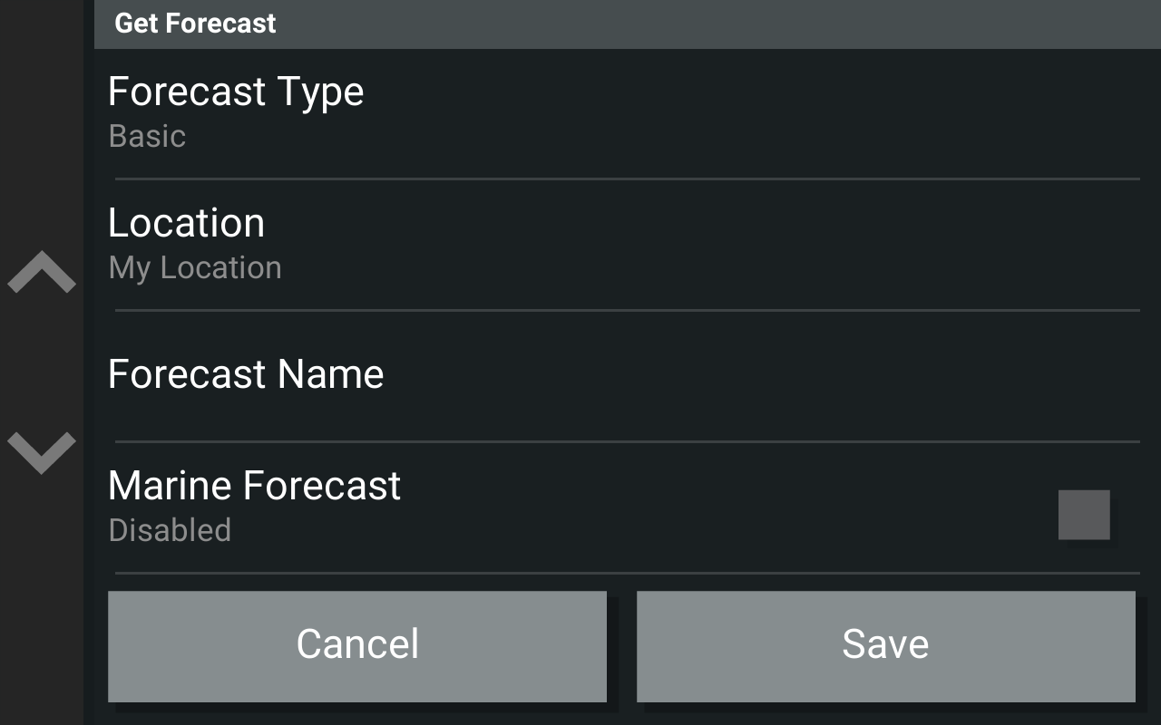

    : Select Forecast Type, Location, or Marine Forecast to change any of these settings.
    • Forecast Type - Select Basic or Premium.
    • Location - By default, the device requests weather for your current location. Select this option and follow the prompts to request weather for a different location.
    • Marine Forecast - Toggle on to receive a marine weather forecast, toggle off to receive a land weather forecast.
  4. Select Save.

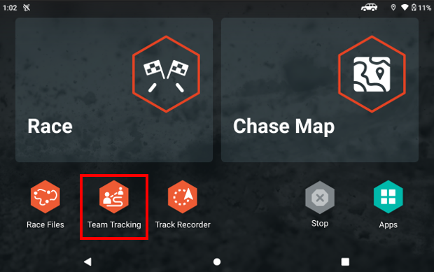

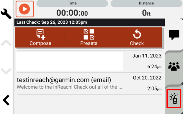

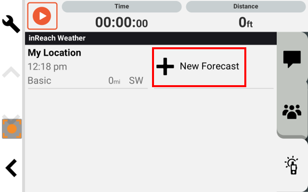

  1. Select Team Tracking from the home screen.
