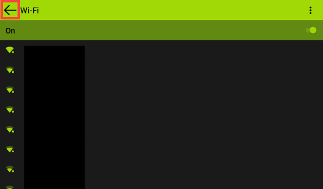

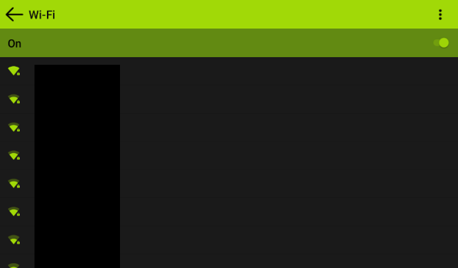

5. Enable Wi-Fi by touching the toggle switch and changing it from Off to On if prompted
6. Select the desired wireless network
7. Enter the password for the network if necessary
    • The device should then connect to the network, and the network will be added to the list of saved networks
    • The device will reconnect to this network automatically when it is within range
8. Press the back arrow
