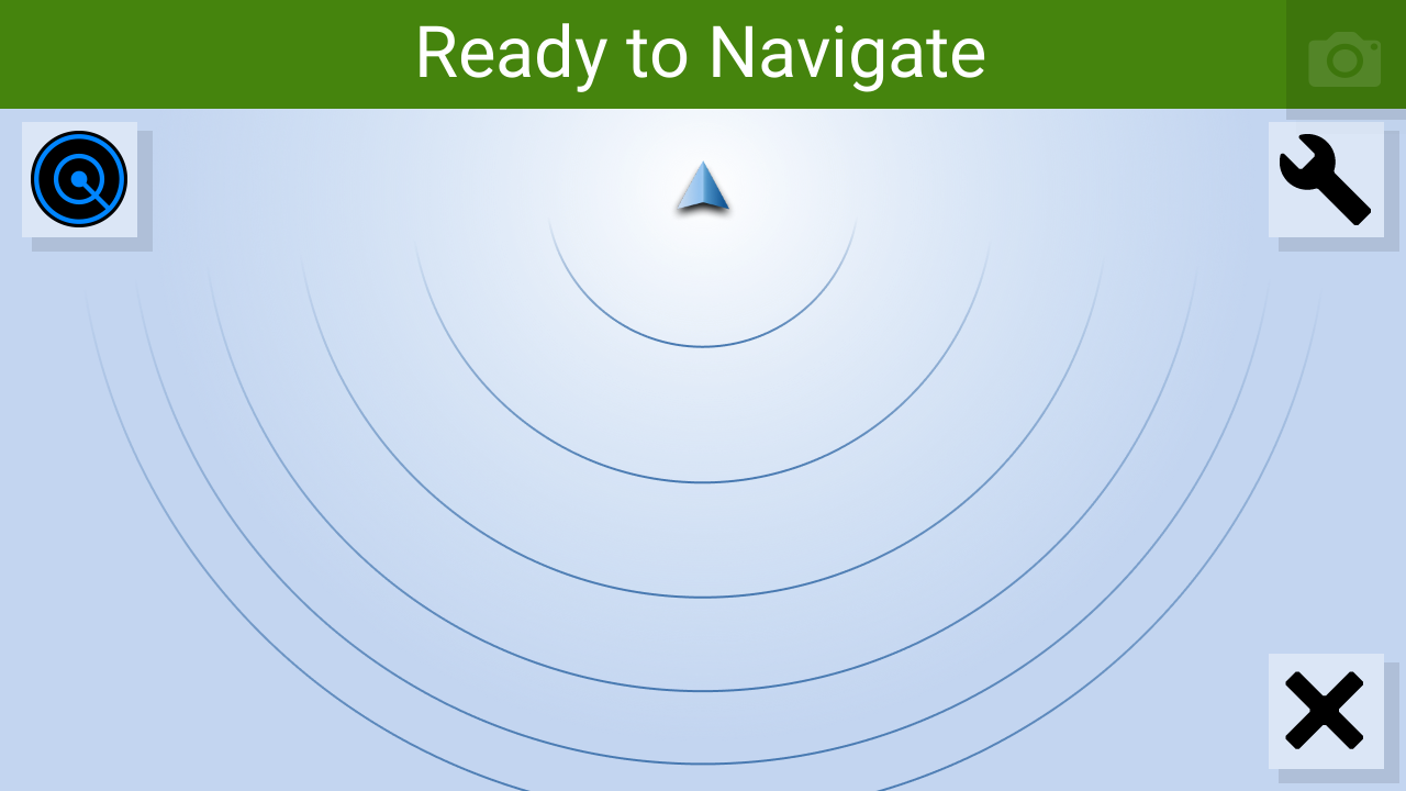

Viewing the Radar Screen
While the zūmo R1 Radar is paired to your navigator, the radar screen can be accessed from the device menu or the map screen.
Device Menu
  1. From the device's home screen, select Apps
  2. Select zūmo™ R1 Radar
  3. The radar screen will now display.

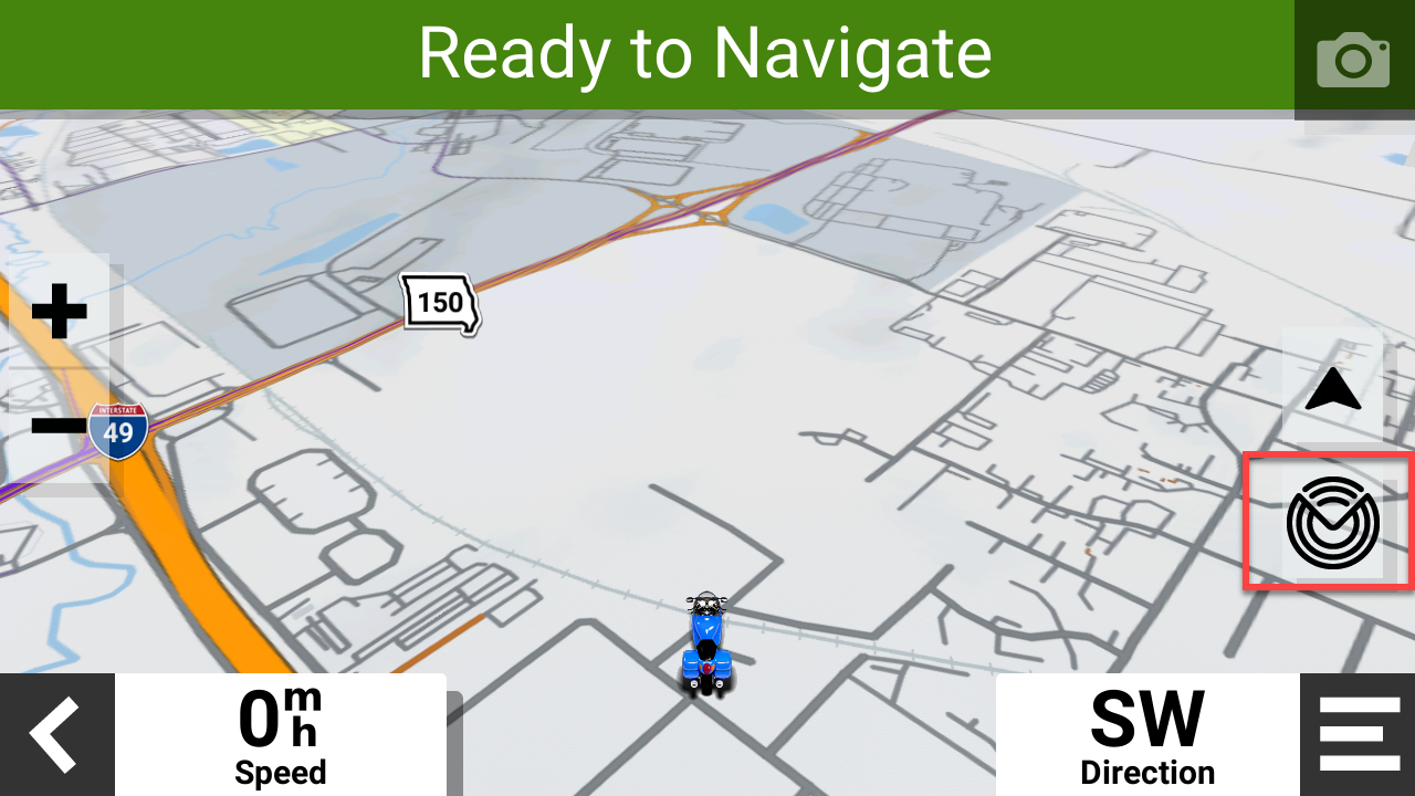

Map Tool Icon:

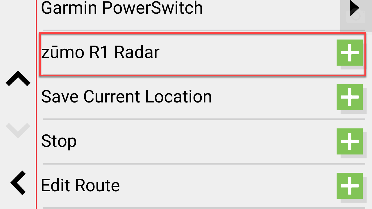

To Add a Shortcut for the zumo Radar Screen to the Map Screen

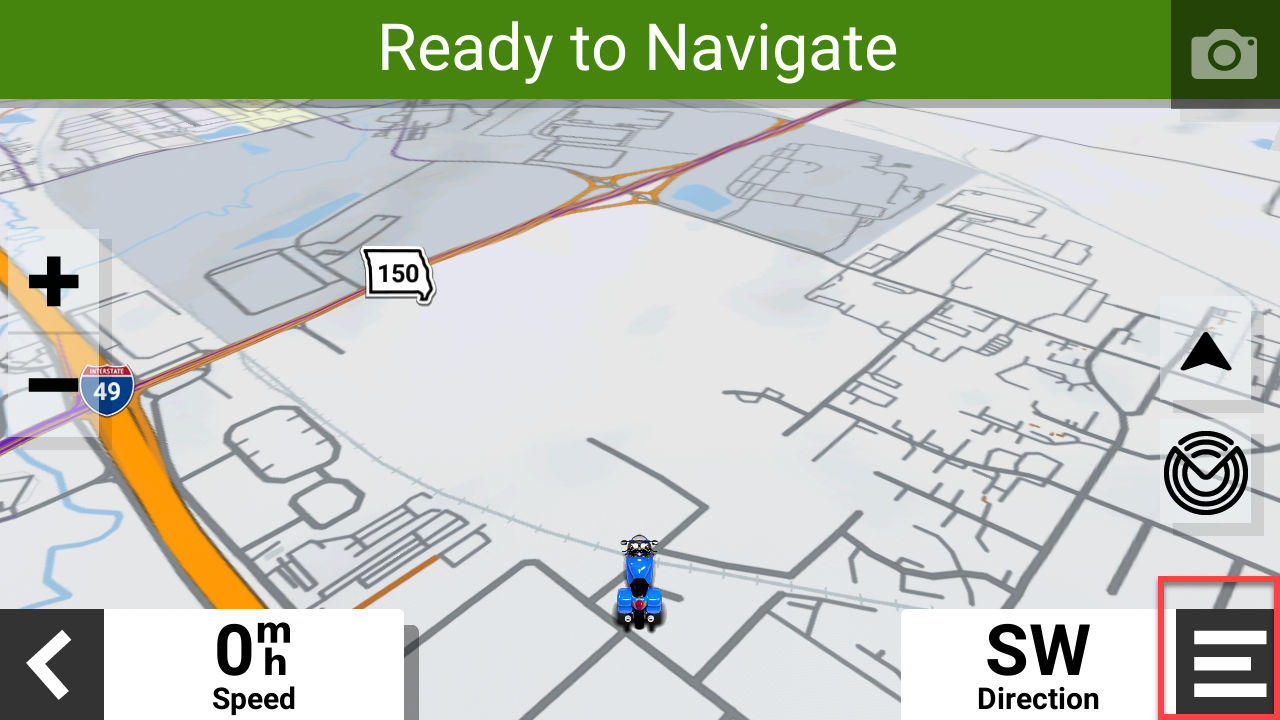

  1. From the home screen, select View Map

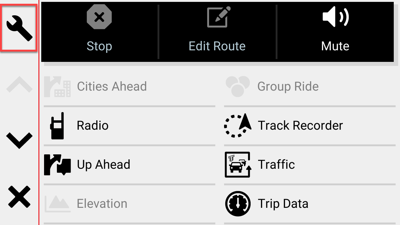

  2. On the map screen, select the menu icon in the bottom right

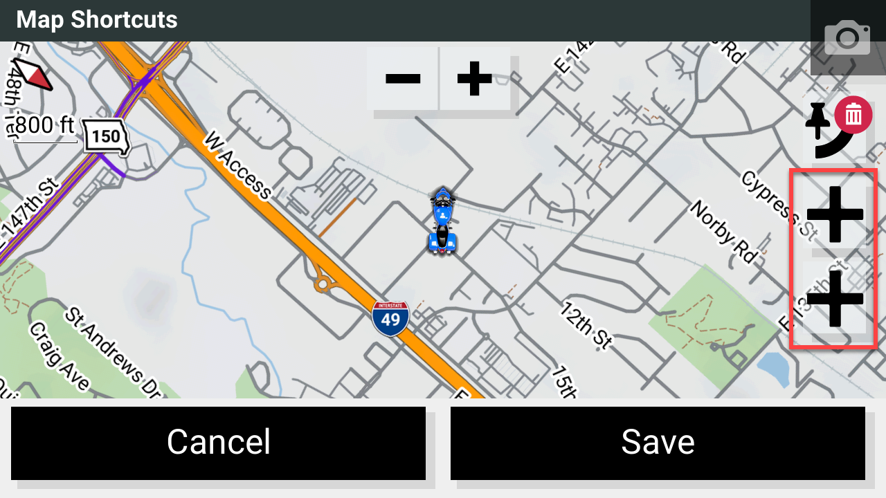

  3. Select the Wrench icon
  4. Select the Plus button

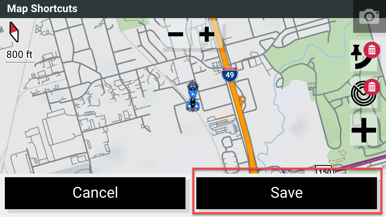

  5. Select zūmo R1 Radar
  6. Select Save
The zumo Radar screen shortcut has been added to the map screen.

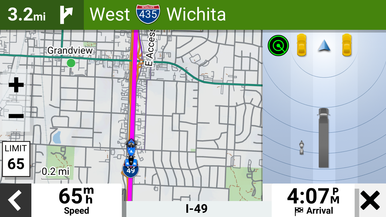

Using the Shortcut for the zumo Radar Screen
  2. On the map screen, select the zumo Radar icon if it is displayed.
  3. The radar screen will be displayed on the right side of the map.
  4. The radar screen can be expanded by touching anywhere on the radar screen.

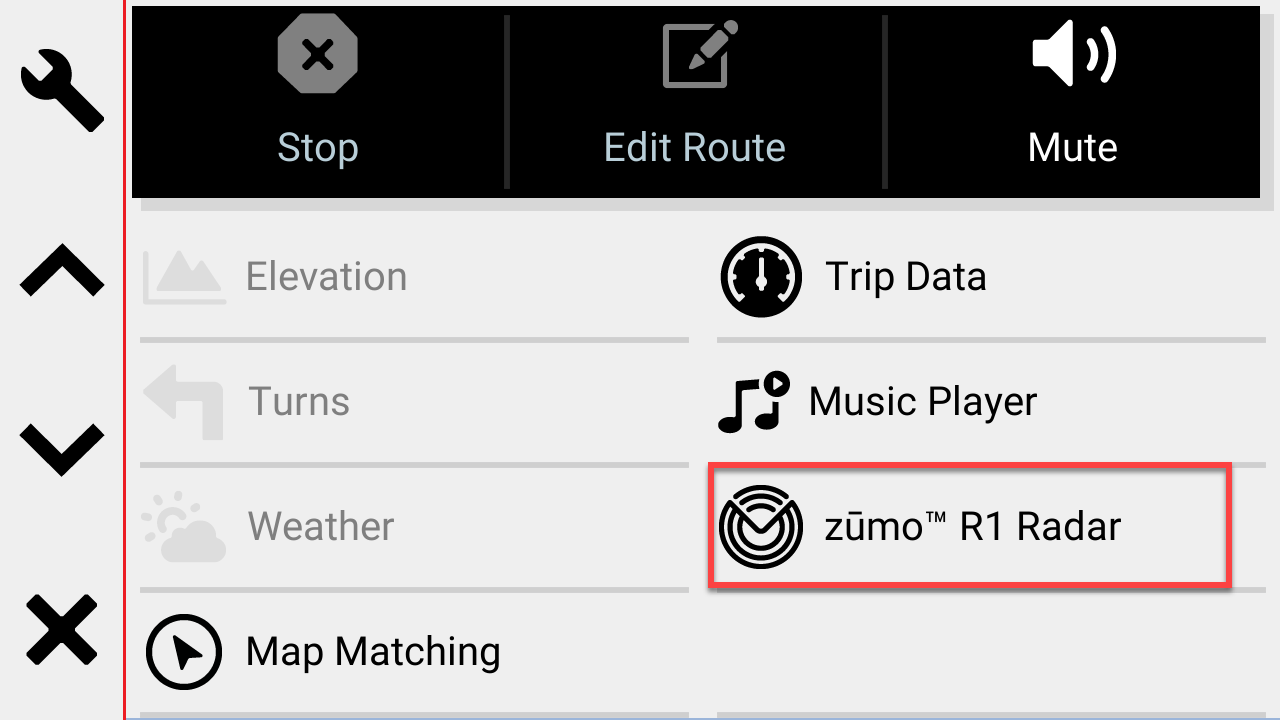

From the Map Menu:

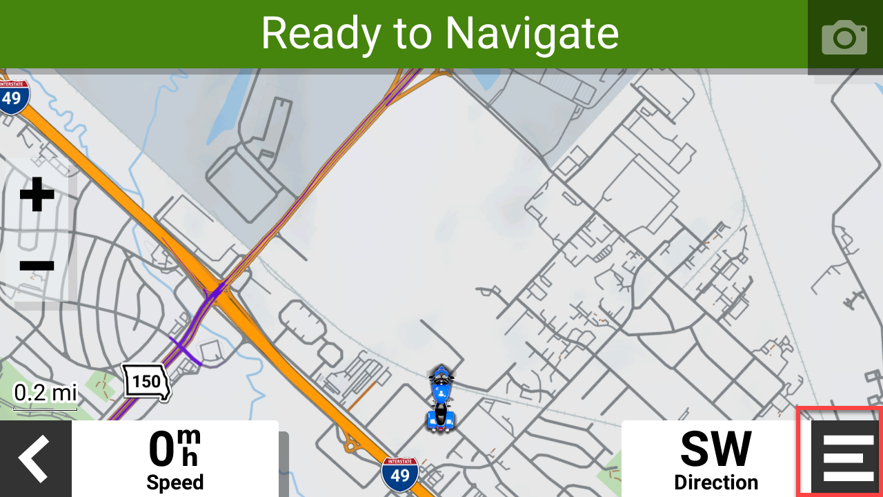

  2. On the map screen, select the menu icon in the bottom right:
  3. Select zūmo™ R1 Radar
  4. The radar screen will be displayed on the right side of the map.
  5. The radar screen can be expanded by touching anywhere on the radar screen.

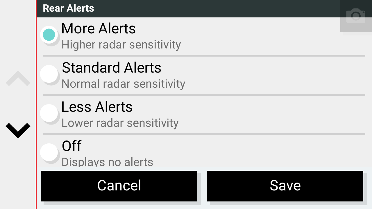

Changing Alert Settings
You can change alert settings on the zumo R1 Radar with your connected navigator.

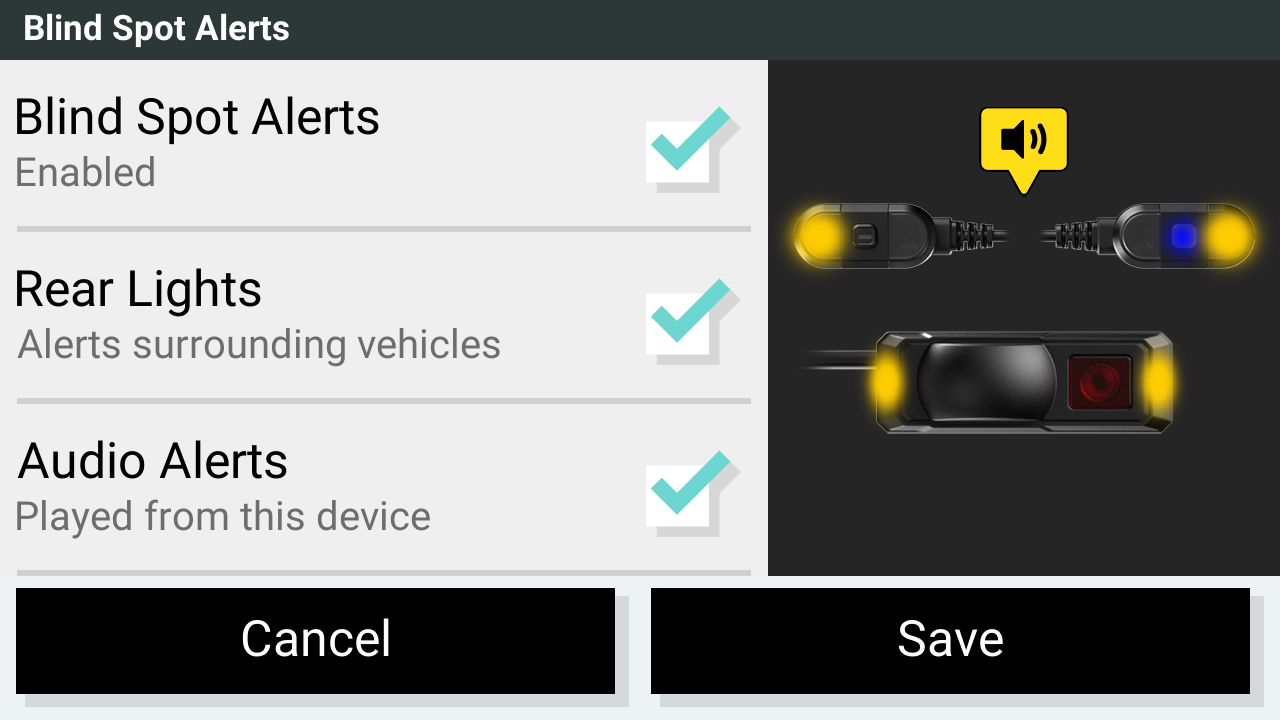

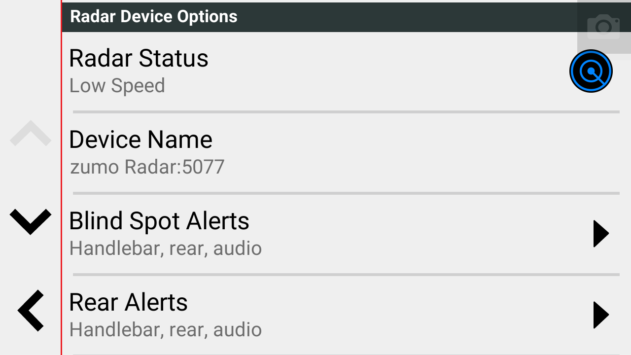

  1. From the Radar Screen, select the Wrench icon zumo wrench icon
  2. Select the connected zumo Radar

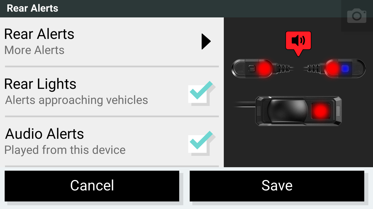

  3. Select either Blind Spot Alerts or Rear Alerts
  4. The following screen for either option will allow you to enable or disable settings, with a preview picture showing how the lights and alerts will change.
  5. Choosing Rear Alerts again will allow you to change the alert sensitivity.
    • More Alerts - High sensitivity, receives all alerts.
    • Standard Alerts - Normal or medium sensitivity, receives the default amount of alerts.
    • Less Alerts - Low sensitivity, receives fewer alerts.
    • Off - Turns off all alerts.
  6. Select Save
