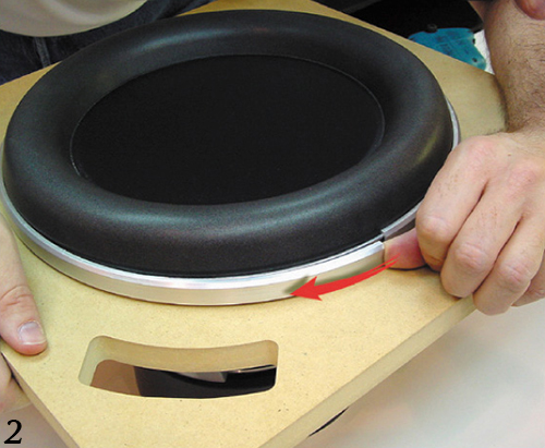

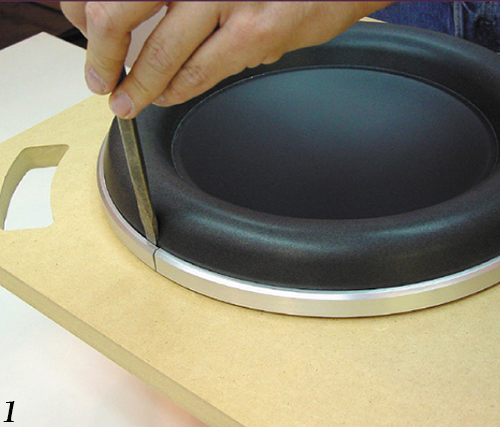

2.) Remove the clamp ring by gently inserting the tip of the large flat-head screwdriver between the aluminum clamp ring and the vertical wall of the foam surround (Image 1).  Pry gently to release one side of the clamp-ring from the frame of the speaker.  Continue around the ring, gently prying the clamp-ring away from the frame one quarter of the way around the speaker.  Once you’ve released one-quarter of the clamp-ring, a gentle push with your thumb in the direction of the speaker circumference will separate the clamp-ring fully (Image 2).  Continue separating the clamp-ring.
Remove a W7 Clamp Ring

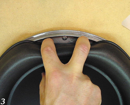

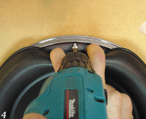

4.) With the O-ring out of the way, the surround is now completely free of the speaker frame.  Lift the surround up and fold it back inside the speaker frame (Image 3).  This exposes the the mounting screws.  While holding the surround back with two fingers, back the first screw out using the electric drill.  Repeat this process eleven more times until all twelve (12) mounting screws are removed from the frame.
W7AE Screw Removal

6.) Line up the twelve holes on the speaker frame with the pre-drilled holes in the enclosure.  Using the included hardware, carefully screw in all twelve (12) mounting screws into the speaker frame (Image 4). It’s important to use the included mounting hardware, inferior hardware (such as drywall screws) may lead to mounting failures.

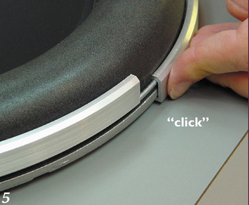

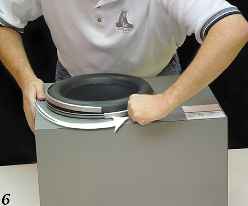

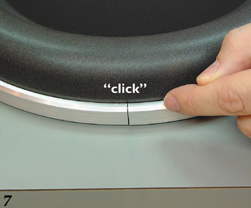

8.) Place the seam of the clamp-ring where it will be least visible in the installation (usually the bottom of the speaker).  Start one end of the clamp-ring by pressing it in firmly  (Image 5).  Next, work your way around the speaker pushing the clamp-ring inward and in the direction of the circumference of the speaker frame (Image 6).  If you’ve achieved a tight fit all around, the seam will be small when you reach the starting point again.  Check the entire circumference for a tight fit.
