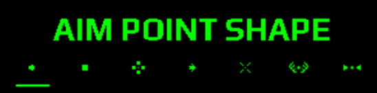

How to Change Aim Point Shape on Xero X1i Scope
The aim point size or diameter on the Xero X1i scope can be adjusted by choosing a different aim point shape in Display Settings.
  1. From Main Menu, select Xero X1i Gear Icon
  2. Select DISPLAY
  3. Scroll down to AIM POINT
  4. Press OK to choose an Aim Point shape
    Xero X1i Aim Point Shape
  5. Select Back to exit
