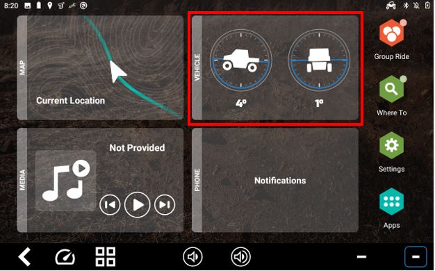

1. Touch Vehicle

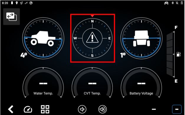

2. Touch the Compass

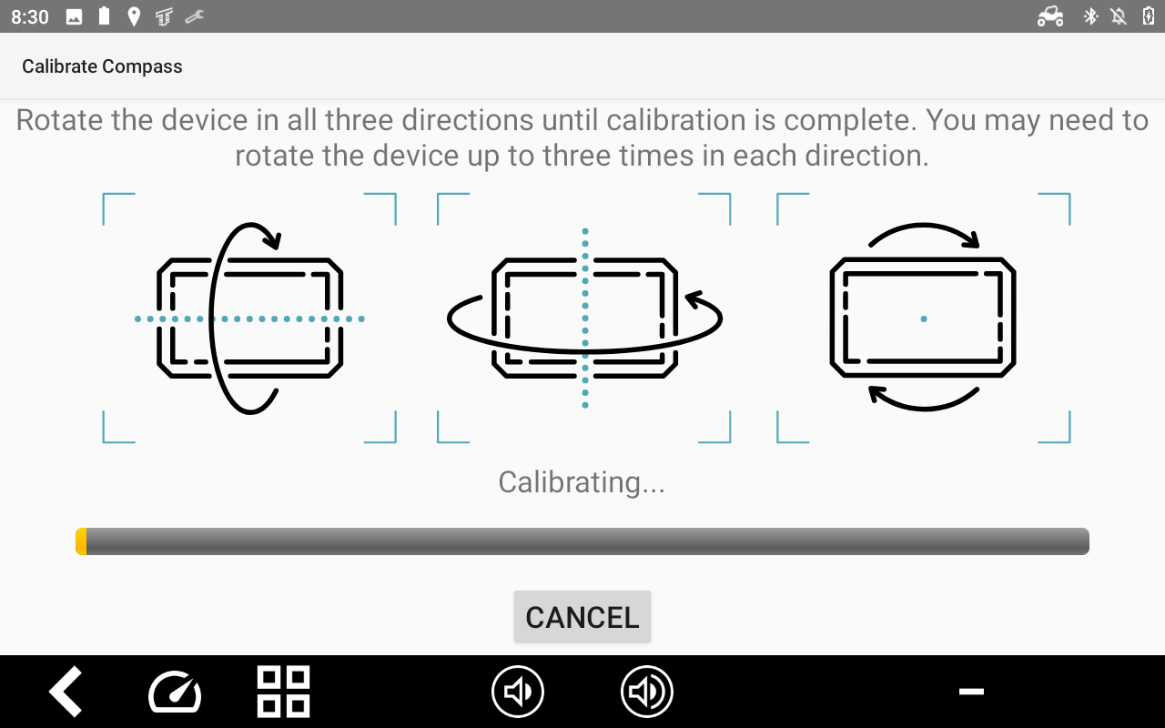

3. Follow the on-screen instructions
