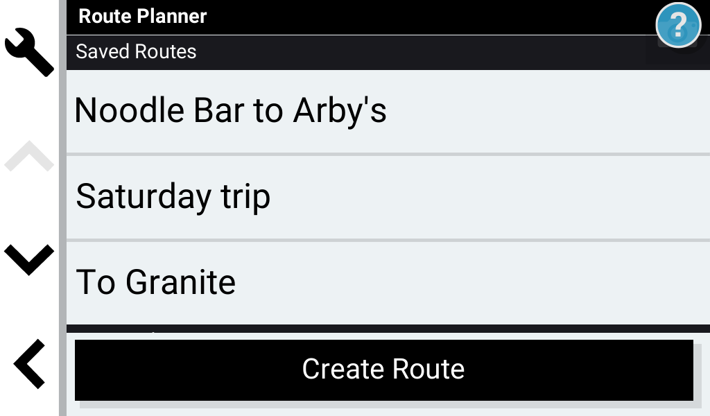

Create a Route
1. Touch Route Planner from the main page
DriveCam 76 Route Planner
Or, tap Apps , then Route Planner
2. Touch Create Route

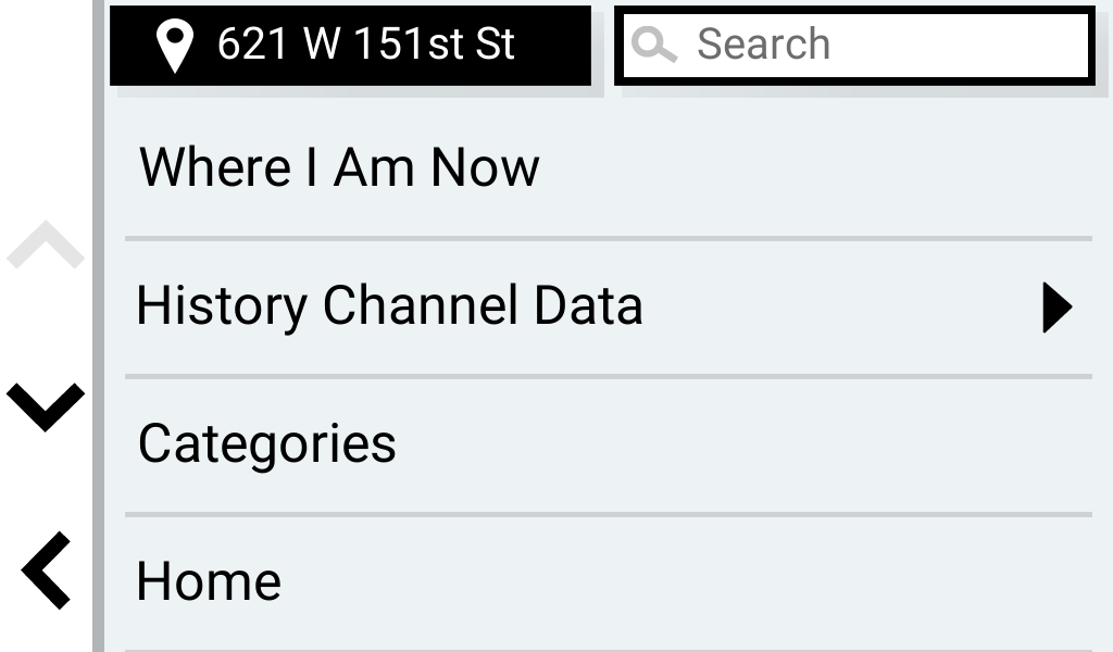

3. Touch Okay to select a start location if prompted.
4. Touch the map to add a start location or select the search icon to search for a location
  • NOTE: The start location is the first stop on the route. You can use your current location as the starting location, but it isn't necessary. The device will skip your current location if that is where you are when it begins to navigate.

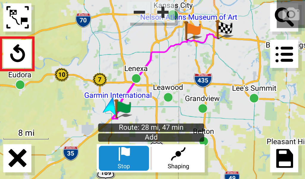

To Add Stops by Browsing the Map
The map can be panned in any direction or zoomed in and out with the  icons to search and select locations.
To remove the last selected location, touch the back arrow in the top left to undo, if necessary.

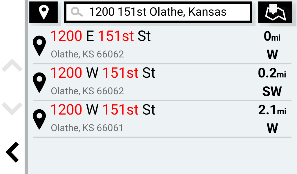

To Search for Stops by Using the Search Icon
1. Touch the Search icon
2. Select the search method:
3. Touch the correct location:
4. Touch Select
Use the map or search options to select additional locations on the route.
To Add Shaping Points
You can insert shaping points to change how the route navigates.
1. Begin by selecting a route segment, which is a section of the route between two locations, then touch Insert
2. Select Shaping to select a location on the map to shape the route.
  • The device will calculate the route again with the shaping point you added.

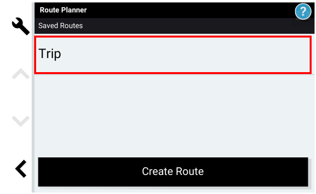

Edit a Route
2. Touch the saved route you would like to edit
3. Touch List
DriveCam 76 Route Planner List
4. Touch any waypoint or shaping point to show editing options

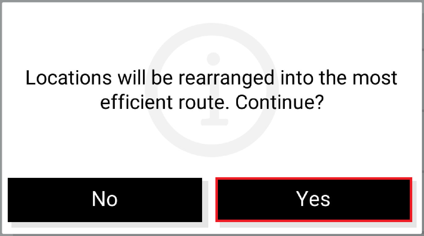

To Optimize a Route (Route Options)
2. Select a saved route
3. Touch the wrench icon
4. Select Optimize Order
  • Additional Route Options: Share, Delete, Rename, Duplicate, View Turns, Suggest Attractions (Tap the down arrow to see all options).
5. Touch Yes to allow the locations to be arranged in the most efficient route
Route Planner will calculate a new optimized route.

To Navigate a Trip Using Route Planner
2. Select the Trip
3. Touch Go
