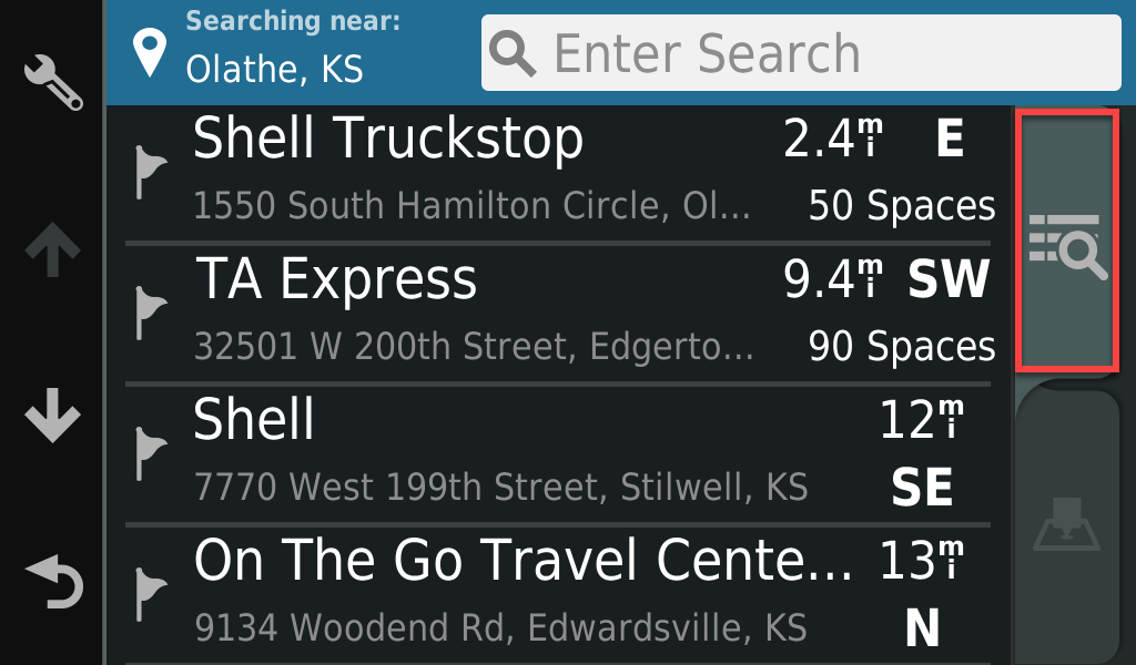

5. Touch the wrench icon or a menu icon in the upper left. You may need to ensure the device is showing the List View first by selecting the top tab on the right.
