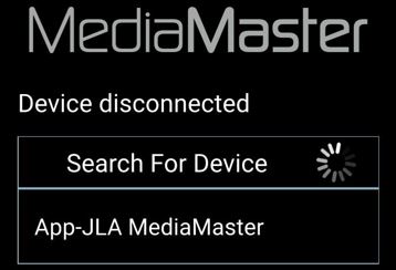

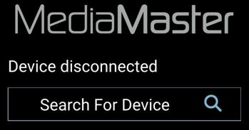

5. Press Search For Device.
MediaMaster Search for Device Bar
6. Select the source unit device App-JLA MediaMaster.
MediaMaster Device Found
