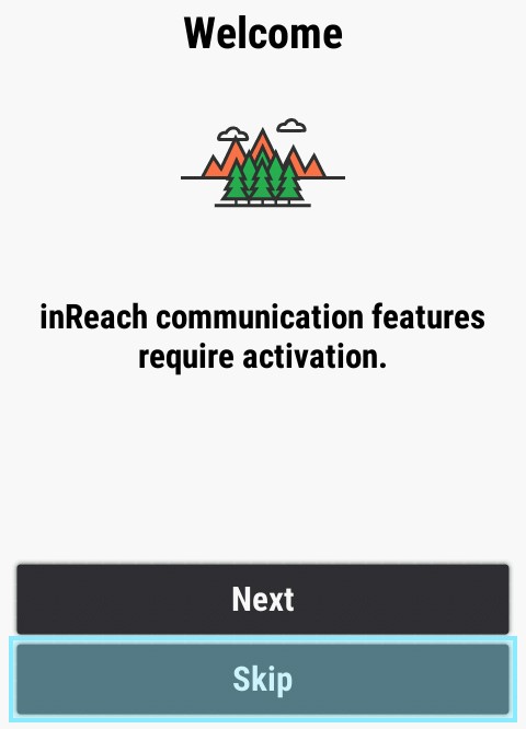

Handhelds With inReach
You may receive a prompt to activate before being able to access other settings on the Montana 700i or 750i. If this occurs, select the option at the bottom of the screen to skip activation, then proceed with the steps above. Activation can be completed later from the main menu.
inReach Activation Prompt
