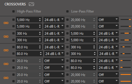

The following Crossover controls are available for each Output Channel of the VXi amplifiers. Each VXi amplifier also gives you the option to set up a crossover for the pre amp output section.
VXi Crossover Image
The TüN™ software provides separate controls for adjusting a High-Pass Filter and a Low-Pass Filter on each Output Channel. These can be combined to create a Bandpass Filter. Each filter section contains the following controls:
Frequency: allows adjustment of the filter frequency (in Hz) via direct numerical entry with the keyboard, or incrementally via the arrows located next to the displayed value. Holding “Shift” down when clicking results in finer resolution steps.
Slope: A pull-down menu allows selection of crossover slopes and filter alignment from a list of available choices:
12, 24 or 48 dB/octave, Linkwitz-Riley (L-R), plus 6 dB/octave and 12, 18, 24, 36, 48 dB/octave, Butterworth alignment (BW)

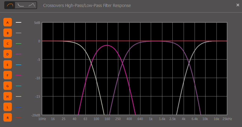

Passband Bar display: shows, at a glance, the approximate passband (bandwidth) of the signal on each channel, based on the crossover frequencies that have been selected. Clicking on the Passband Bar Display will open a window with a large, detailed view of the crossover filter’s response. Once this window is open, you can show and hide channels to evaluate the crossover settings. The detailed crossover response view can also be called up by clicking on the Crossover menu  
Clicking the VXi Icon icon next to the CROSSOVERS label at the top of the crossover section provides a detailed view of the entire system showing all crossovers and their actions.  Channels can be removed or added depending on the view desired.VXi Passband
