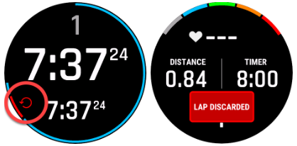

  2. Within the time window, press DOWN (bottom left button) to undo lap.
  3. Lap Discarded will show on the screen when lap is removed.
After being removed, the lap will no longer be counted toward the activity.
