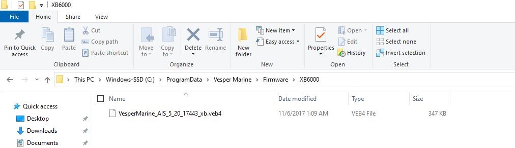

  5. Run the vmAIS Configuration and Status program that was installed in step 2. On Windows, find it in the Windows Start menu in the Vesper Marine folder
  6. Select the correct COM port under the Com Port dropdown menu and click the “Connect” button
  7. Select the “Firmware Update” tab
  8. Use the “Browse” button to select the firmware file. Example file names (the numbers will be different for each firmware release): VesperMarine_AIS_5_20_17443_xb.veb4
