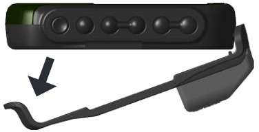

  2. Snap the Charging Cradle to the unit with the 4-contact end in first.
    Foretrex 201 Charging Clip
