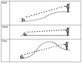

  • Line-of-sight: Any physical obstruction between the handheld and dog collar will reduce the effective range. To achieve the best line-of-sight conditions, you should move to the highest elevation point in your area (for example, on top of a hill):
