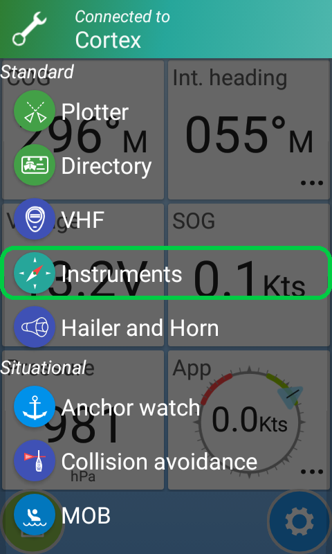

Go to the main menu and tap the config (wrench) icon.
Cortex Configuration Wrench Icon

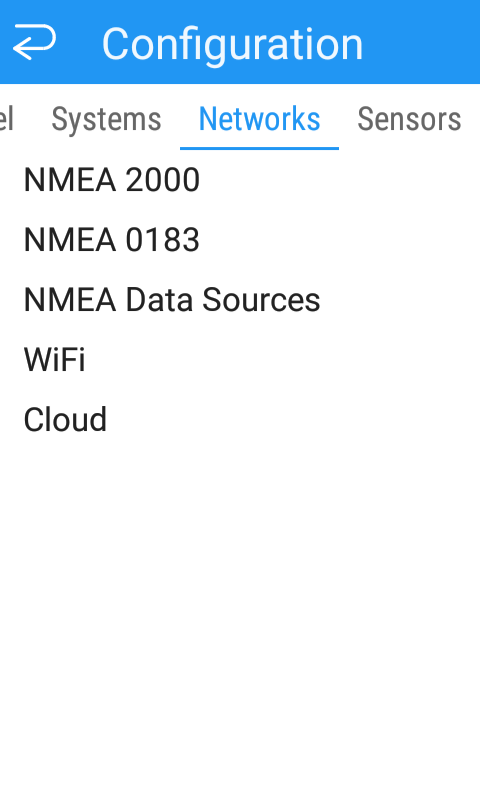

Go to the Networks tab and then select NMEA Data Sources.
Configuration Networks Option

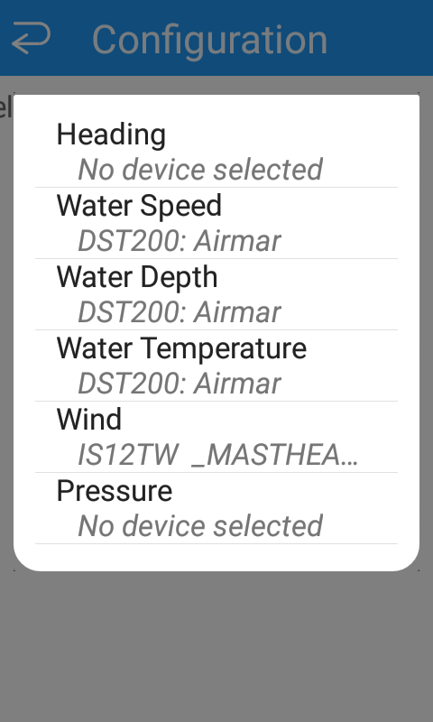

Configuration Data Sources Options

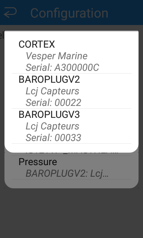

Select the sensor to change. In this example we will change the pressure sensor.
Configuration Options Pressure Sensorp;
The selected device will now be shared across the NMEA bus.
