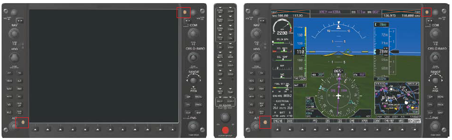

  1. Check that there is nothing blocking the photoelectric cells on each display, and that the protective glass is clean. See below for the location of the photoelectric cells on the bezel of the G1000®:
    • The photoelectric cells will be on diagonally opposite ends of the bezels. However, they may be positioned on the upper left and lower right quadrants of the bezels instead of what is shown above.
