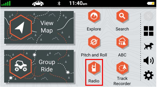

- Touch Preset to view the available radio presets.
- Touch Channel to view the available MURS channels.
- Touch Open (Manually adjust squelch for static noise), CTCSS (Continuous Tone-Coded Squelch System), or DCS (Digital Code Squelch) depending on what current mode is selected to view the additional options.
3. To Choose a squelch code within the current mode, select the plus or minus.

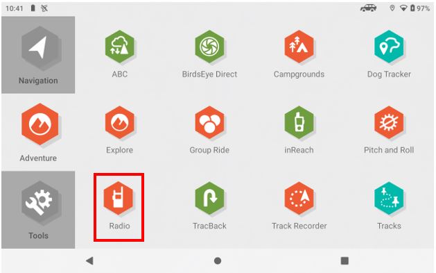

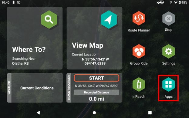

2. Touch Adventure or Apps.
- Skip this step on some devices
3. Touch Radio.
5. To Choose a squelch code within the current mode, select the plus or minus.
