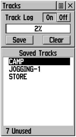

Saving the Current Track Log
  1. Use the THUMBSTICK to highlight 'Tracks' and then press it in to select it.
  2. Use the THUMBSTICK to highlight 'Save' and then press it in to select it.
  3. The Save Back Through window appears giving you a time frame for saving a track or 'Entire Log.'
    eTrex Venture Save Back Through
  4. Use the THUMBSTICK to highlight the time and date that you would like to save the track through, then press in on the THUMBSTICK to save the track log and display the Track page.
The track is now saved in the 'Saved Tracks' list on the Tracks page.
Clearing the Track Log
  1. Press PAGE until the Main Menu page appears.
  2. Use the THUMBSTICK to highlight 'Tracks' and then press it in to select it.
  3. Use the THUMBSTICK to highlight 'Clear' and then press it in to select it.
    eTrex Venture Tracks Page
  4. Use the THUMBSTICK to highlight 'Yes' and then press it in to select it.
