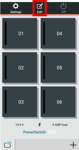

2. Select Edit to customize a button

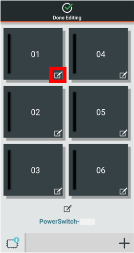

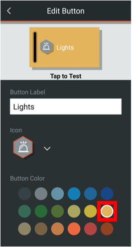

3. Select the Pencil icon on a button

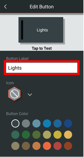

4. Enter a Button Label to change the button name

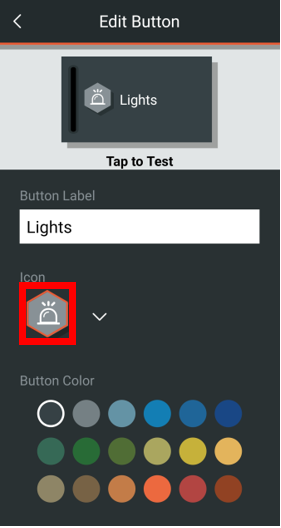

5. Select an icon for the button

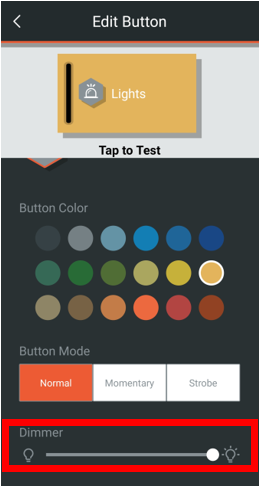

6. Select a button color

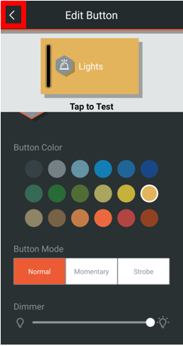

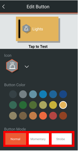

7. Select Normal, Momentary, or Strobe mode to customize performance
8. Adjust the slider to change the intensity

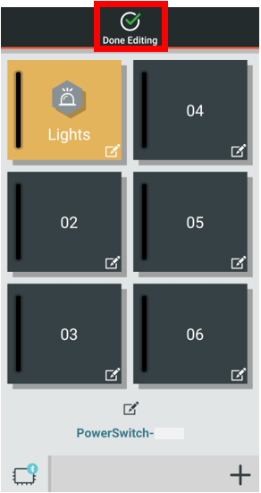

9. Select the back arrow when finished customizing
10. Select Done Editing to save the changes

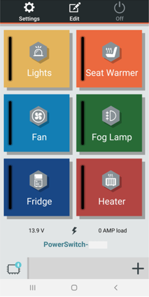

    • Example of all buttons customized
