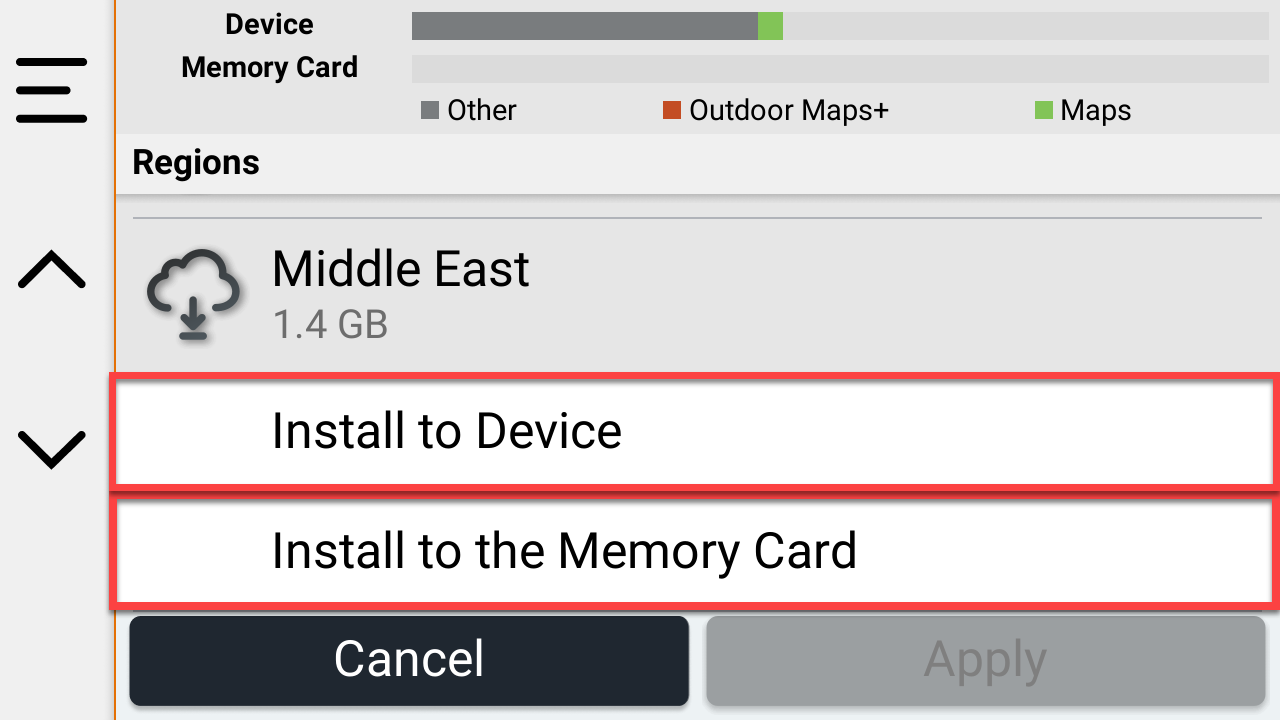

3. Touch the desired map region to download and select Install to Device or Install to the Memory Card if a memory card is inserted.
  • If installing to a memory card, the card must remain in the device for the map to be recognized.
  • If the memory card is removed, the mapping content will then be available to download to the device's internal storage.
Install device or mem card

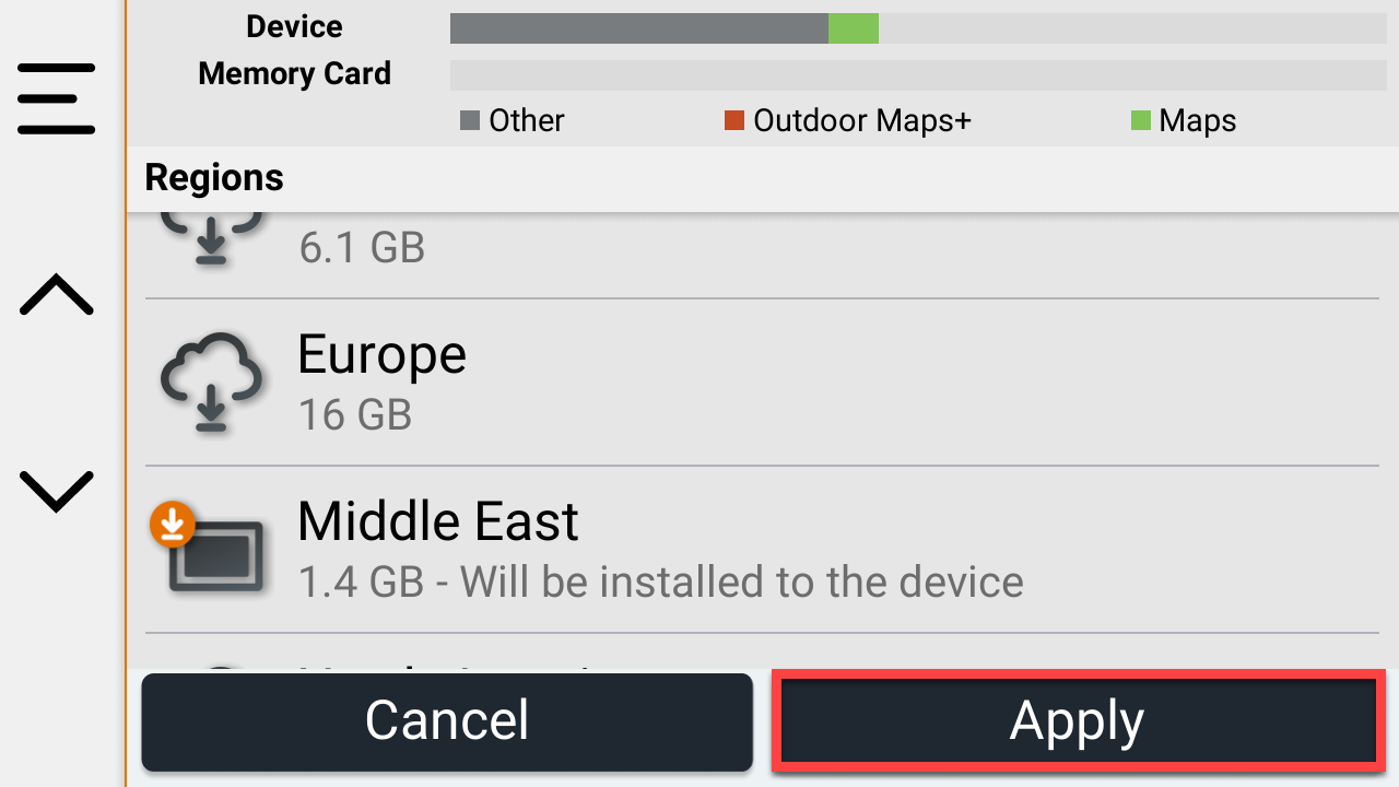

4. Touch Apply to begin the installation
  • Multiple maps can be installed simultaneously if desired.
  • Installed maps cannot be moved between internal and external storage. Map content will need to be removed and installed on the desired storage type as needed.
Install to device tread 2

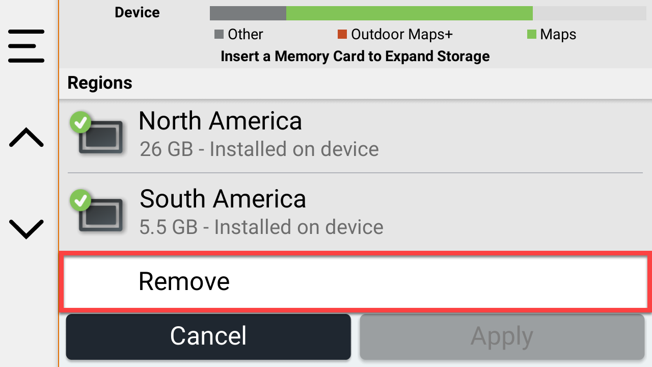

3. Select the desired mapping to uninstall, and touch Remove.
Remove map tread 2

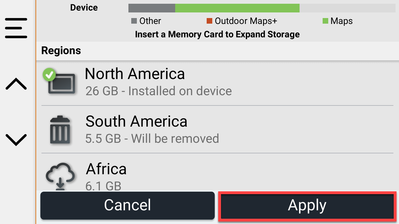

4. Touch Apply to begin the removal of the map.
Apply to Remove Map
The map will then be uninstalled from the device.

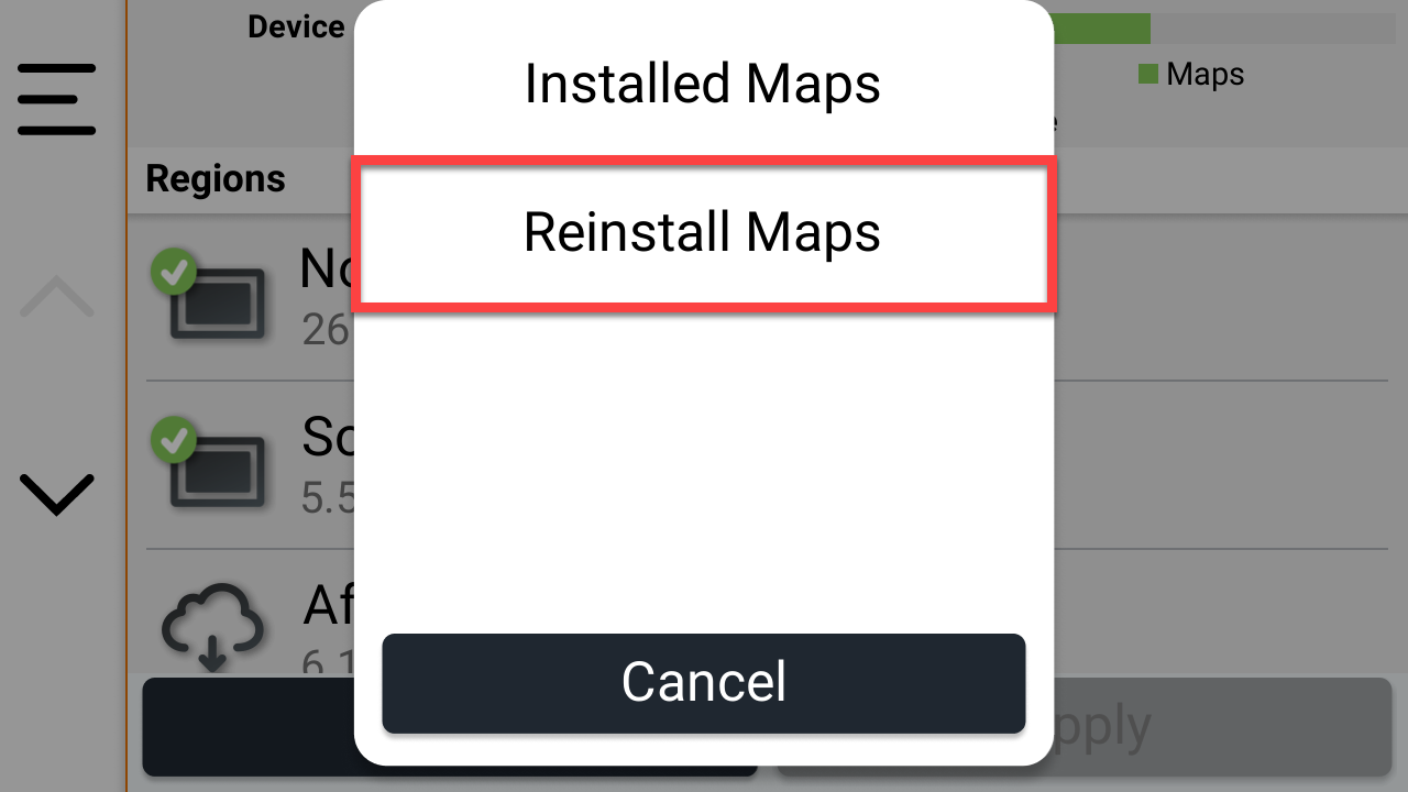

3. Select the three lines 3 lines icon  in the upper left corner and touch Reinstall Maps.
Reinstall maps tread 2

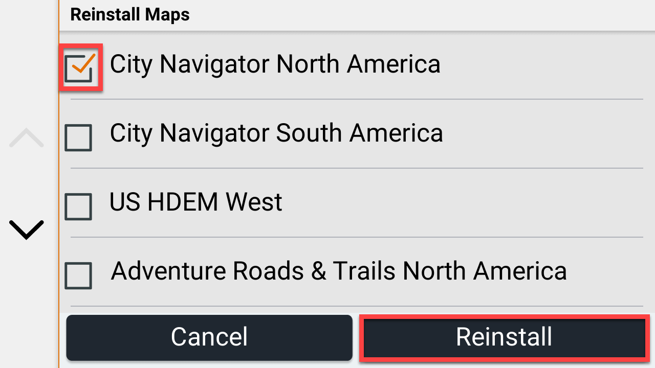

4. Touch a map from the list to be reinstalled, and select Reinstall.
Reinstalling a map tread 2
The map reinstallation will begin.
