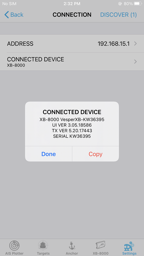

Now go to the WatchMate app on the iOS device. Open the device then do the following:
Press on the bottom right
Select Settings
Select Connected Device
The IP address 192.168.15.1 will be listed here along with Connected Device "XB-8000"
The app can now be used.
