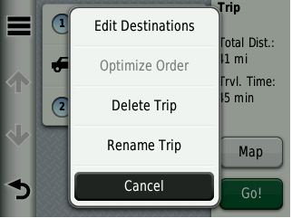

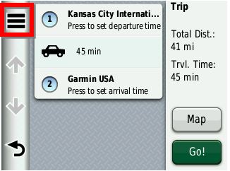

To Edit or Delete a Route/Trip:
1. Touch Tools
2. Touch Trip Planner
3. Touch the name of the route you would like to edit
4. Touch
5. Select from the following options:
  • Edit Destinations: Add or remove points from the route
  • Optimize Order: Have the device calculate the most efficient order to travel to all the entered points
    • Note: The start point and endpoint will not be changed when optimized
    • Note: You must have at least four waypoints to optimize the order
  • Delete Trip: Removes the trip from Trip Planner
  • Rename Trip: Customize the name of the trip as it appears in Trip Planner
NOTE: To reverse the order of the trip, the order of points would need to be rearranged manually.  This would replace the trip originally entered and would not create a new trip.
