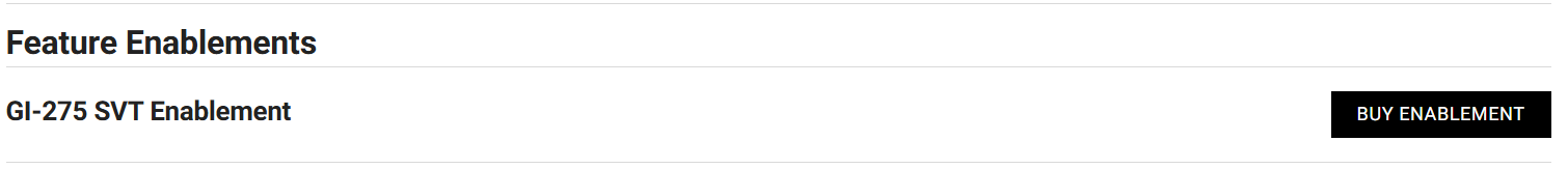

  4. Scroll down and select Buy Enablement within the Feature Enablement section.
    • GI 275 Buy SVT

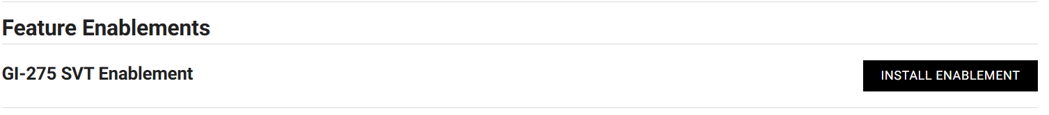

  7. Scroll to the bottom on the Device Details page, and select Install Enablement within the Feature Enablement section.
    • GI 275 Install SVT
