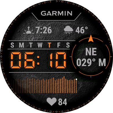

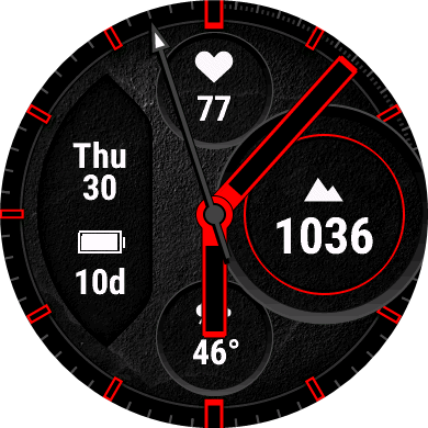

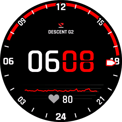

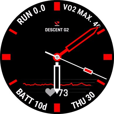

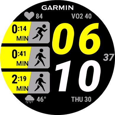

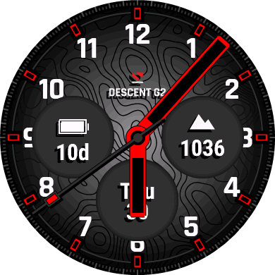

Watch Faces Templates Available on Descent G2 Watches

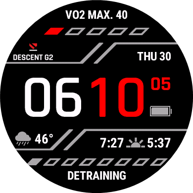

Descent G2 watch face example with digital time and smart watch icons

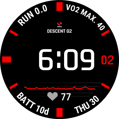

Descent G2 watch face example with watch hands and smart watch icons

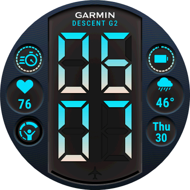

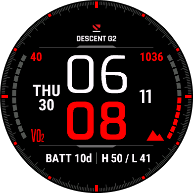

Descent G2 watch face example with watch hands and heart rate graph
