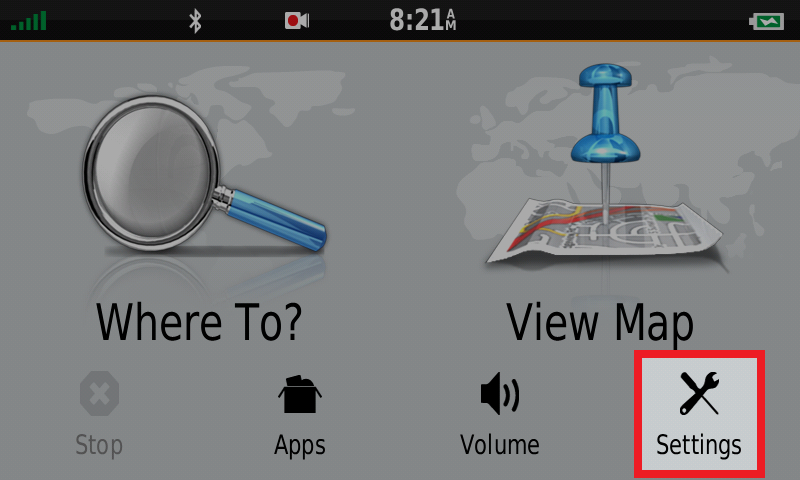

To Check Automatic Incident Detection Settings:
1. Touch Settings

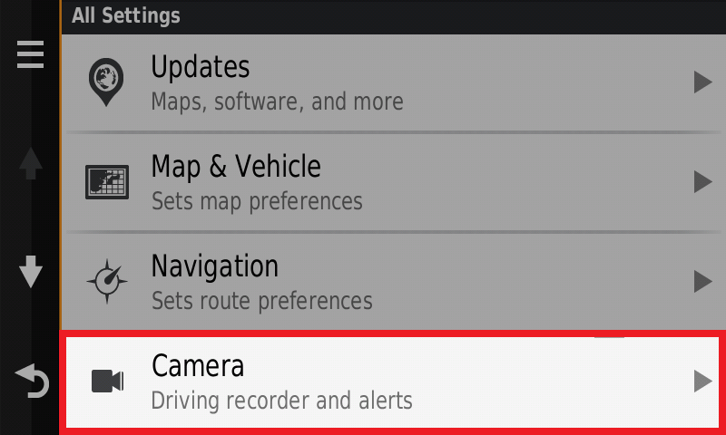

2. Touch Camera

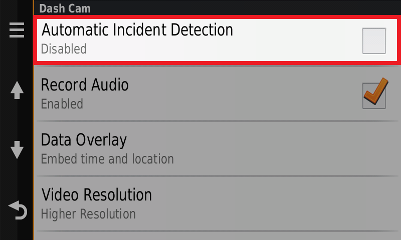

3. Touch the  down arrow twice
4. Touch Automatic Incident Detection to add a  checkmark if it is unchecked

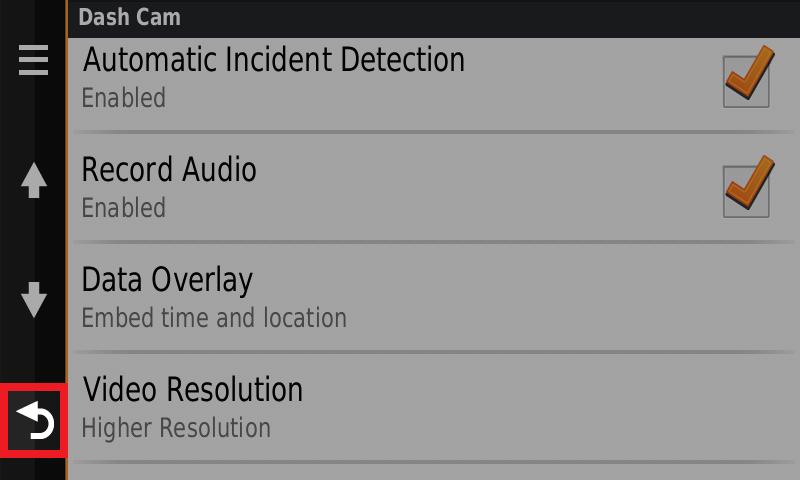

5. Touch the back arrow to save changes
The device will now automatically save video when it detects an event.
