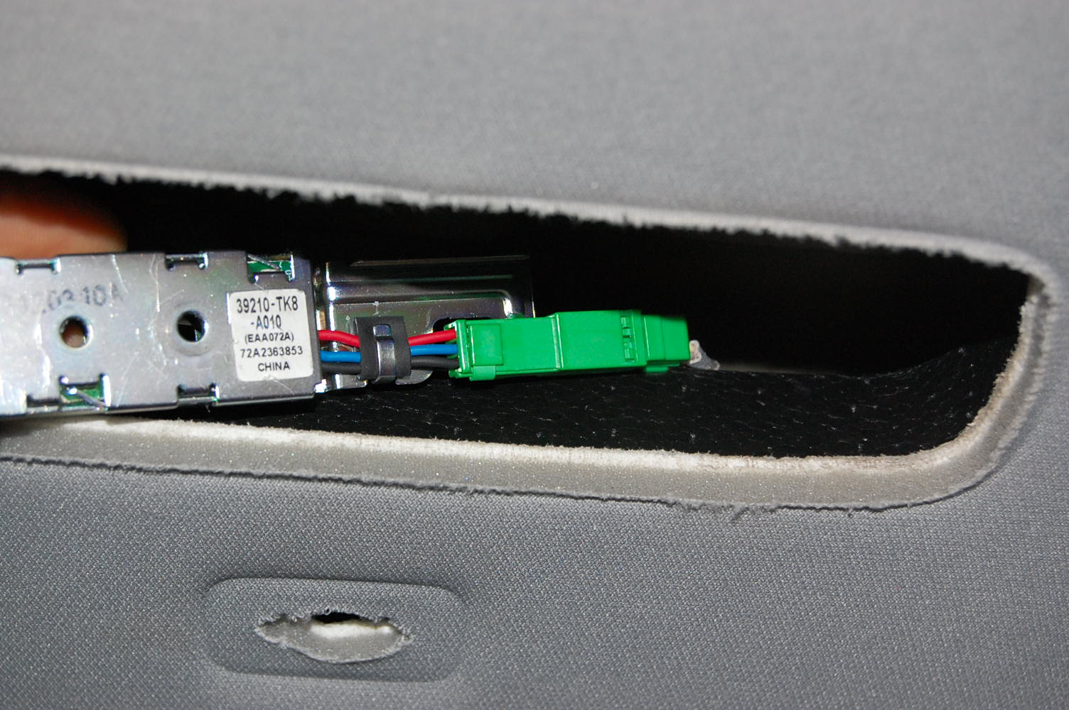

Option 2: Physically disconnecting the microphones in a vehicle has become a popular way of dealing with this issue, not necessarily because it’s the easiest but it’s the one that works almost every time. The tricky part is making sure all the microphones are disconnected, the most popular locations include the headliner (front and rear of vehicle) and inside of the door panels (driver and passenger front doors).This works great for many of today's ANC systems, but vehicles that accentuate engine noises also use a signal generated by the motor to feed the processor in the noise cancellation system and this method would not address that issue.
Honda Pilot ANC headliner microphone removal
2012 Honda Pilot - rear microphone removal
Note: It is important to verify the only microphones being disconnected affect the ANC system and not the Bluetooth/Handsfree system.

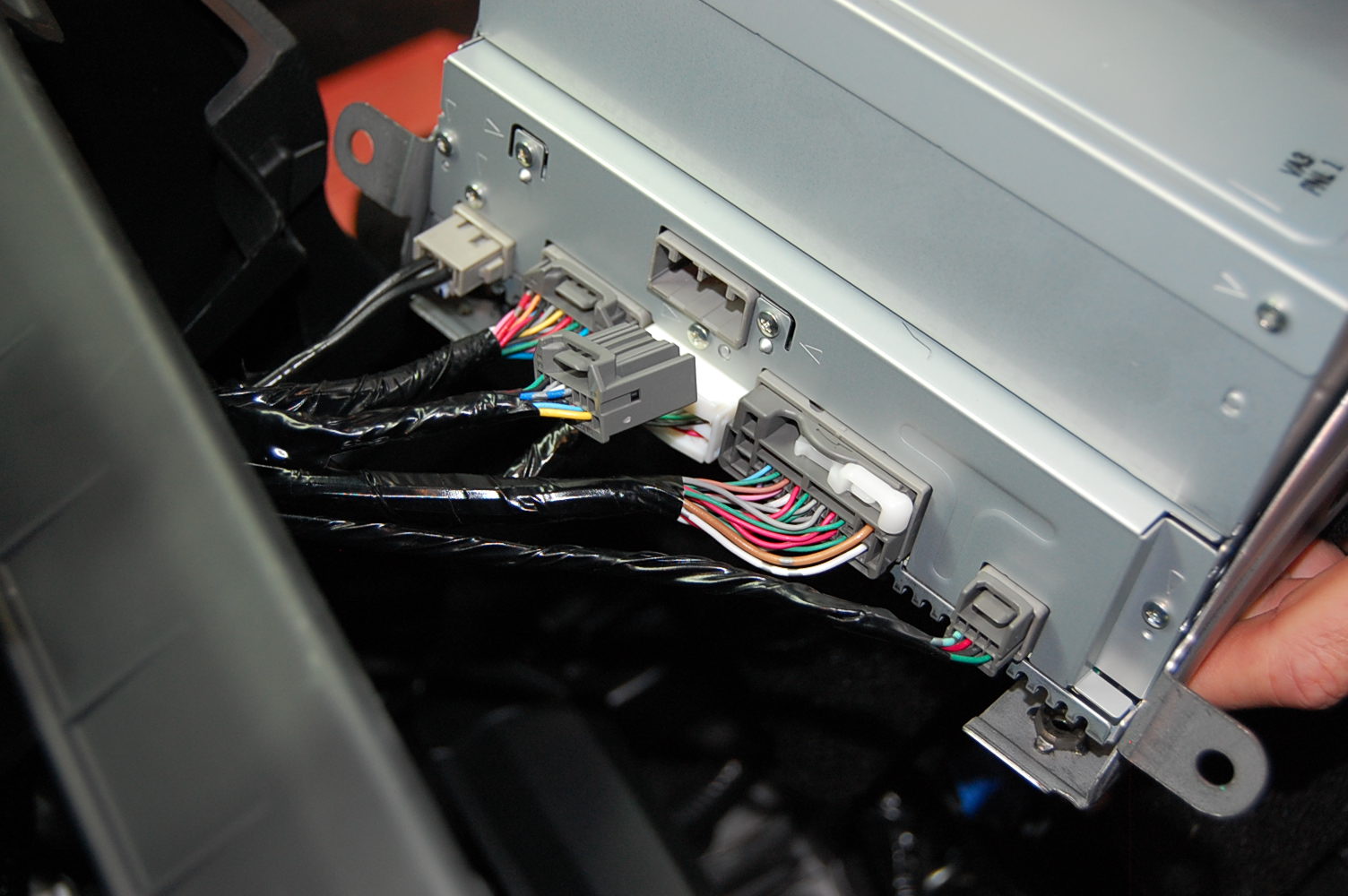

Option 3: Disconnecting the signal wires at the factory radio, amplifier, or ANC module is a guaranteed way to stop the system from interfering with your upgraded audio system. Using different available programs, professionals can look up the wiring schematics of a vehicle to find where the microphone or engine RPM signal wires are going connected in relation to the ANC system. By interrupting these wires, we eliminate the possibility of the system damaging our audio signal.
Honda Crosstour ANC disable and removal
2012 Honda Crosstour - ANC harness removal
