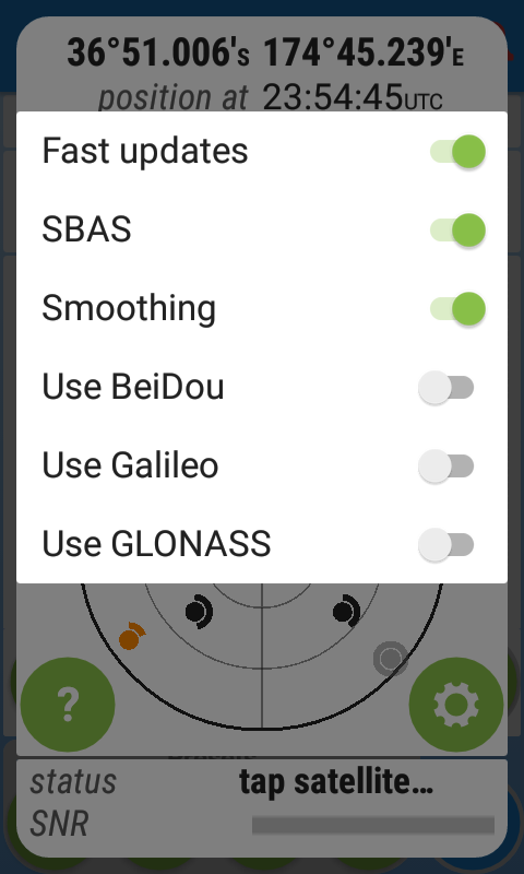

To check the GPS health on the handset and with the Cortex Onboard™ app (Android). iOS is very similar- tap the GPS icon and the GPS status page comes up
Tap the GPS icon on the top of the banner
This will bring up the satellites in view and and the type of satellite, and whether active or inactive. You see the symbols used by tapping the ? .
You can also make changes to the GPS options by tapping the gear icon.
To get to the settings on iOS
Menu>Config>Hub setup>Systems>GPS
