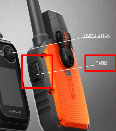

Button and Key Functions
The controls for the Alpha 10 handheld are operated primarily through the thumbstick and menu button. If you need additional information on how to use them see the appropriate section below.
Using the Thumbstick
Thumbstick Button
  • The Alpha® 10 dog tracking handheld has an omnidirectional thumbstick that is used to navigate in menus and tools.
  • The thumbstick can also be clicked-in to serve as the Enter or Select key for selecting highlighted functions and options.
  • Moving the thumbstick to the left can be used to return to the previous menu/page.
Menu Button Function
The large rectangular button on the side is the Menu button.
Menu button
  1. Pressing Menu will show the Main Menu
    • The Main Menu shows:
      • Start Hunt
      • Mark Truck
      • Add Device
      • Setup
  2. Pressing Menu again will close the Main Menu and return you to the Tracked Device List

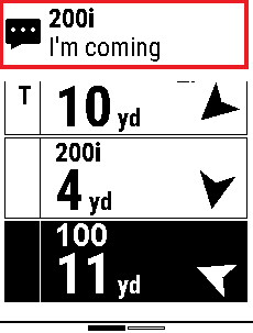

Sending a Message to All Tracked Contacts
The Alpha® 10 dog tracking handheld allows you to send and receive preset text messages from other Alpha series handhelds. Once paired, the other Alpha handhelds will show on your Tracked Device list along with their dog collars.
Sending a Message
You can send a preset text message to all your tracked contacts at once. The Alpha 10 handheld does not allow for individual contact messaging. It sends messages to anyone that is currently actively tracking you via VHF/MURS.
  1. From the list of Tracked Devices, move the thumbstick to the left to enter System Notifications.
  2. Select Send Message.
  3. Highlight a message to send.
  4. Push the thumbstick in to select Send.
Receiving a Message
When you are using your device and a message is received you can select the message to view it or you can move the thumbstick to the left to return to the previous screen.
Once the notification fades you can view the previous message by viewing the System Notification page.
