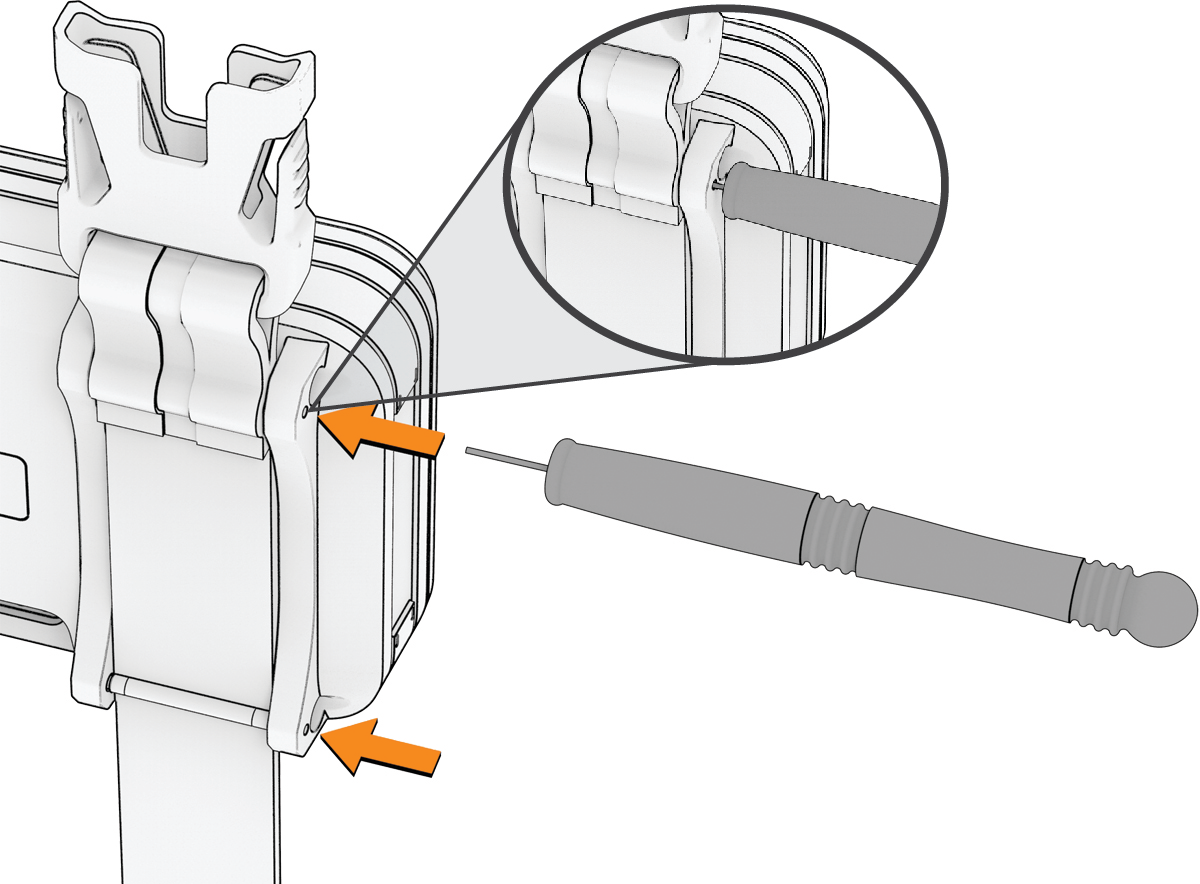

Steps to Remove the Band
Use caution when removing the spring bars from the dive computer, as they are spring loaded.
  1. Locate the holes on the outside of the arms securing the spring bar pins.
  2. Insert the band removal tool into one of the holes.
    Arrow indicating direction to press pin
  3. Remove the pin as the tool compresses the end of the pin.
  4. Repeat the above steps for the other spring bar pin.
  5. Push the spring bar out of the sewn pocket in the band (if necessary).
If you need to remove both bands from the dive computer repeat the steps for the other band.
