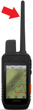

- The detachable antenna must be connected to the handheld.
