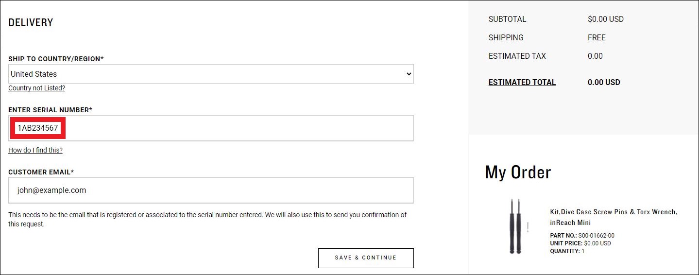

      2. Enter your inReach Mini handheld's serial number.
        NOTE: Letters must be capitalized.
        Example
        Dive Case Order Form Serial Number Entry

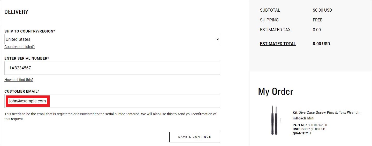

      3. Enter the email address that was used when registering your inReach Mini handheld through the Garmin Express program.
        TIP: This information can be found in Garmin Express under Tools & Content > Info
        Example
        Dive Case Order Form Email Address Entry
