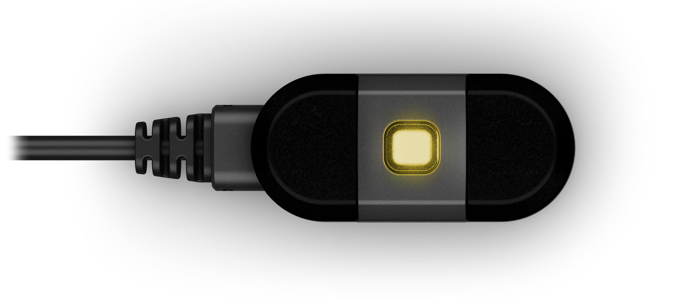

Solid Yellow
Single Yellow Flash (After Button Press)
  • The indicator lights are enabled. The rear lights are off, but radar detection is working.

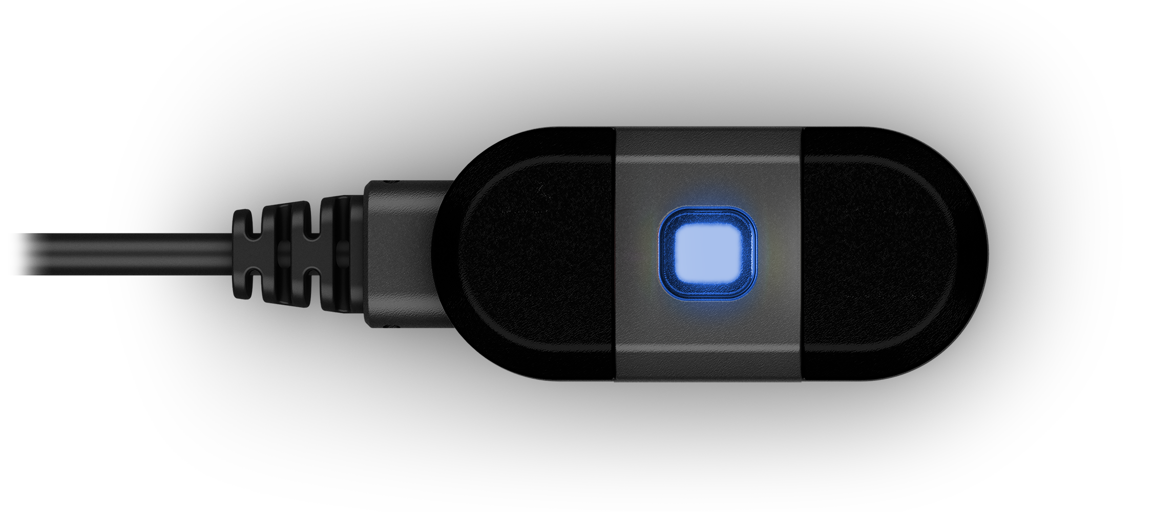

Solid Blue - Normal Operation
  • The device features are limited because the motorcycle is traveling at a low rate of speed.
  • No vehicles are shown on the zūmo Radar app or connected navigator.
  • While in this mode, the handlebar lights will not alert the rider when a vehicle is alerted with the rear red light.
  • If a fast approaching vehicle from behind is detected in this mode, rear lights will flash to warn the approaching vehicle.
Flashing Blue - Bluetooth
  • The device is in Bluetooth pairing mode. The light will pulse for three minutes, until a Bluetooth device is paired, or until the device button is pressed.
