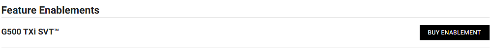

To purchase the enablement in Fly.Garmin.com, go to the "Devices" tab. Once you have added your G500 TXi with its System ID, select the G500 TXi by clicking on it. Scroll down and click on "Buy Enablement" within the Feature Enablements section.
Buy SVT
