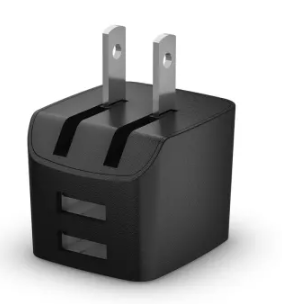

Use a Garmin-branded AC power adapter accessory, such as a wall power adapter.
  • A full charge via a Garmin AC power adapter may take 5 hours.
  • When you plug the device into an AC charger and push the button to turn it “off”, the device will remain on enough to charge the battery, then fully suspend or turn off.
Note: Place the device screen side down when charging to reduce stress on the device's USB port.
       Wall charger
