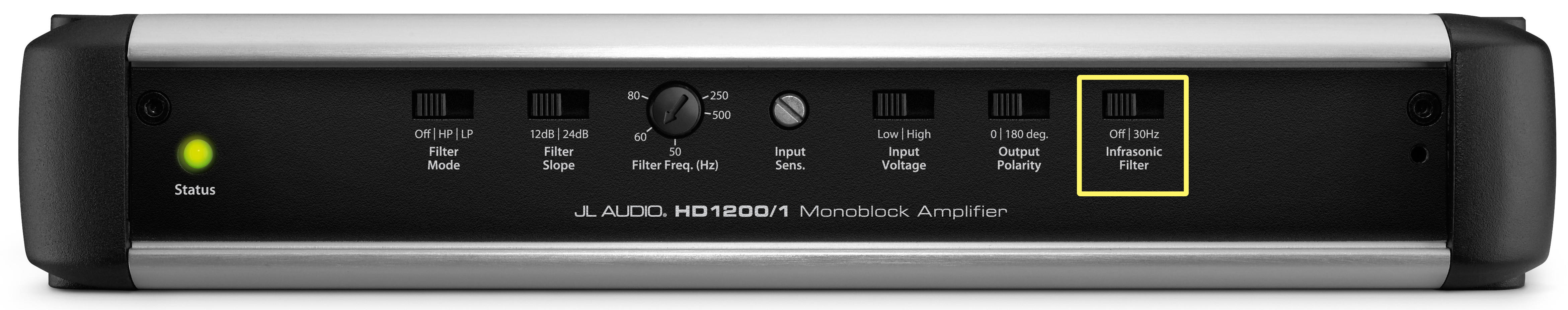

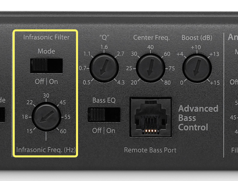

When used with a ported enclosure, we always recommended turning the Infrasonic Filter on your amplifier on. In some cases, the filter has a fixed center frequency between 25-30 Hz. When this is the case, you would simply turn the filter on. In other cases, the Infrasonic Filter Frequency may be variable. If this is the case, we suggest setting the frequency to 5 Hz below the tuning frequency of the ported enclosure.
