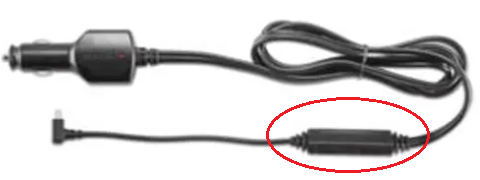

USB-C Vehicle Power Cable
This cable contains a traffic antenna (block/bar in the cable as shown below) to acquire the traffic signal for those GPS navigators that include a traffic receiver embedded within the device.
USB-C with 'block'
Adapter styles may vary with different devices.

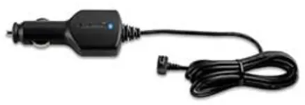

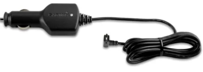

Vehicle Power Cable (TA - Traffic Antenna)
This traffic antenna/power cable works with compatible automotive devices that come with a traffic receiver embedded within the device.
TA Cable 'no block'
The color of the LED light may vary with different cables.

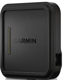

Vehicle Power Cable and (Powered Magnetic Mount with Video-in Port and HD Traffic)
The provided vehicle power cable used with a Powered Magnetic Mount with Video-in Port and HD Traffic (sold separately) will provide live traffic.
  • Compatible with the dēzl™ OTR800, dēzl™ OTR810, dēzl™ OTR820, dēzl™ OTR1000, dēzl™ OTR1010, dēzl™ OTR1020, RV 890, RV 895, RV1090, and RV 1095 GPS navigators.
Power cable       Video Mount
