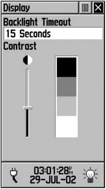

Setting the Timeout and Adjusting the Contrast
  1. Press PAGE until the Main Menu page appears.
  2. Use the THUMBSTICK to highlight 'Setup' and then press it in to select it.
  3. Use the THUMBSTICK to highlight 'Display' and then press it in to select it.
  4. Use the THUMBSTICK to highlight and select 'Backlight Timeout' or the 'Contrast' slider and make any desired adjustments.
    eTrex Legend Display Settings
