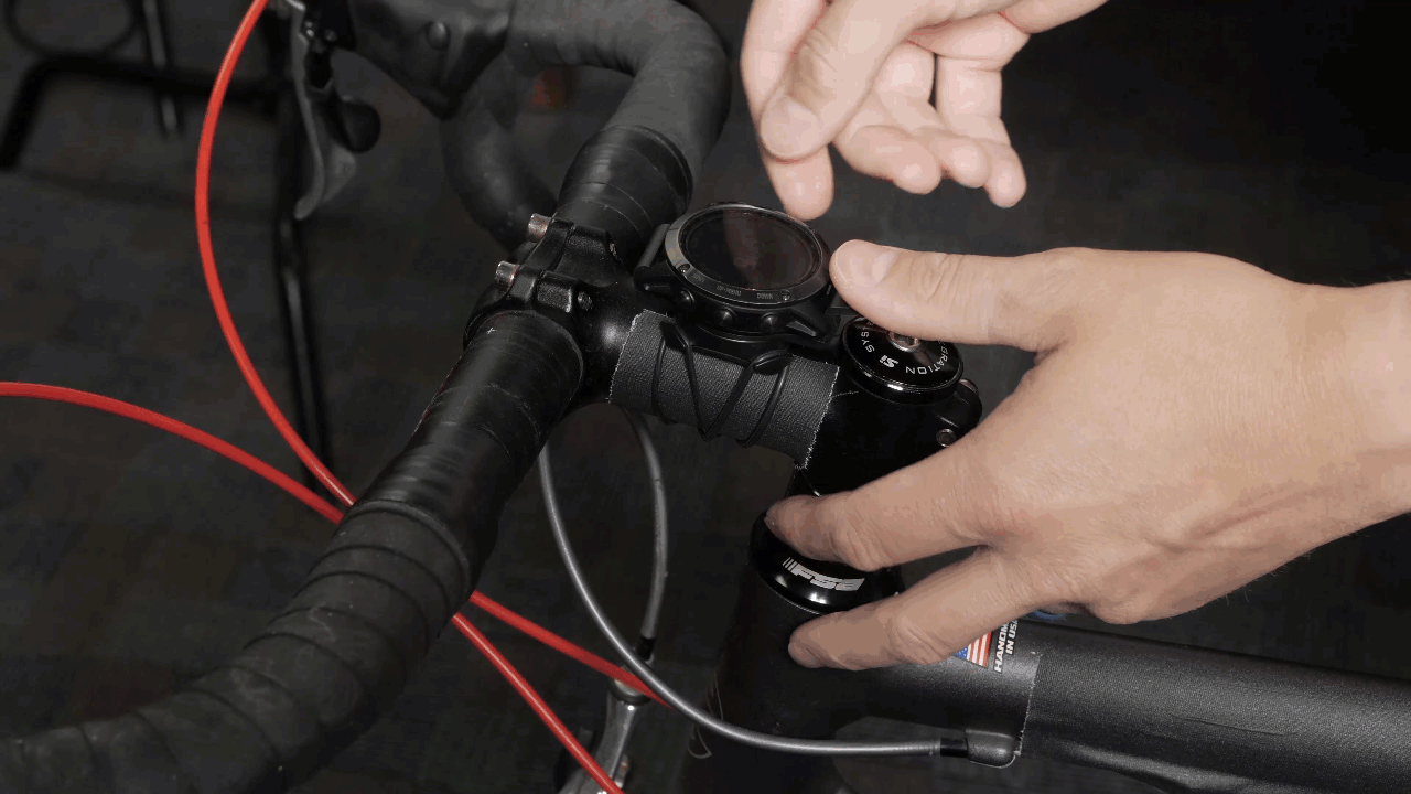

  3. Place the bike mount on the bike stem.
    Example
    bike mount placement
  4. Use the appropriately sized o-rings to secure the bike mount.
    Example
    securing the mount

  8. Once the QuickFit mount has been attached to the watch, place it in the bike mount and rotate it 90 degrees to lock it into place.
    Example
    locking in the mount
