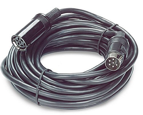

M101RXCRET 24 foot wired remote extension cable (6-pin 1998 to 2008)
JL Audio 24 foot wired remote extension cable (6-pin 1998 to 2008)

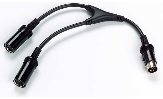

M101RYCRET wired remote y-adapter cable to connect multiple wired remotes (6-pin 1998 to 2008)
JL AUdio wired remote y-adapter cable to connect multiple wired remotes (6-pin 1998 to 2008)
M101RC-W, M101RC-B, M102RCW-R, M102RCB-R, M201RCS, M202RC-RET, M301RC-RET, CMRC1BSS, CMRC1SB, CMRC2BSS, CMRC2SB, and CMRC3D wired remotes use 6-pin connections.

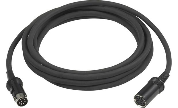

MWRXCRET 25 foot wired remote extension cable (8-pin 2009 to present)

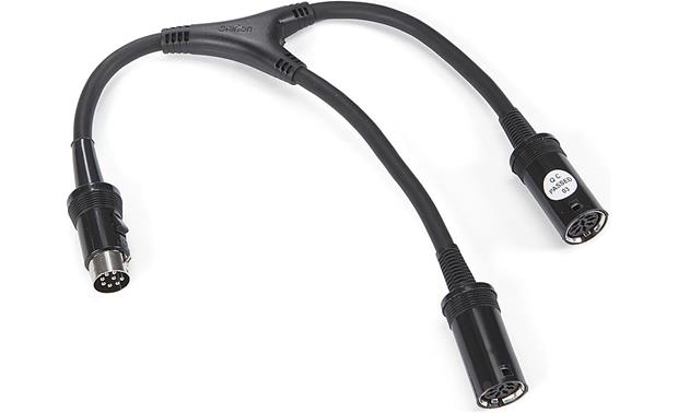

JL AUdio wired remote y-adapter cable to connect multiple remotes (8-pin 2009 to present)
MWRYCRET wired remote y-adapter cable to connect multiple remotes (8-pin 2009 to present)
JL Audio wired remote y-adapter cable to connect multiple remotes (8-pin 2009 to present)
MW1, MW2, MW3, and MW4 wired remotes use 8-pin connections.
