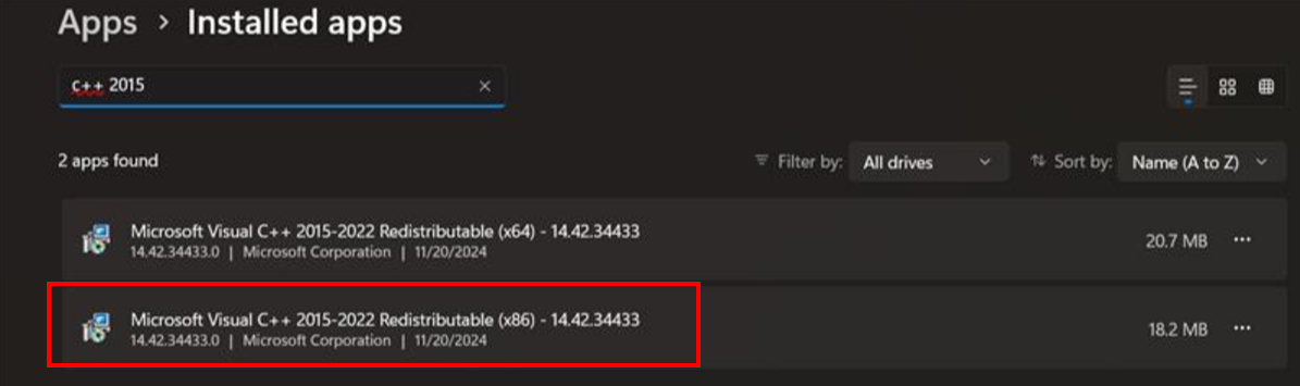

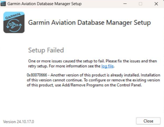

Setup Failed Error When Installing or Updating the Garmin Aviation Database Manager
- Open Installed Apps in your Windows settings and search for c++ 2015.
- Locate and Uninstall the x86 Redistributable:
- This should should allow the Garmin Aviation Database Manger to be installed. Re-attempt the installation or update.
