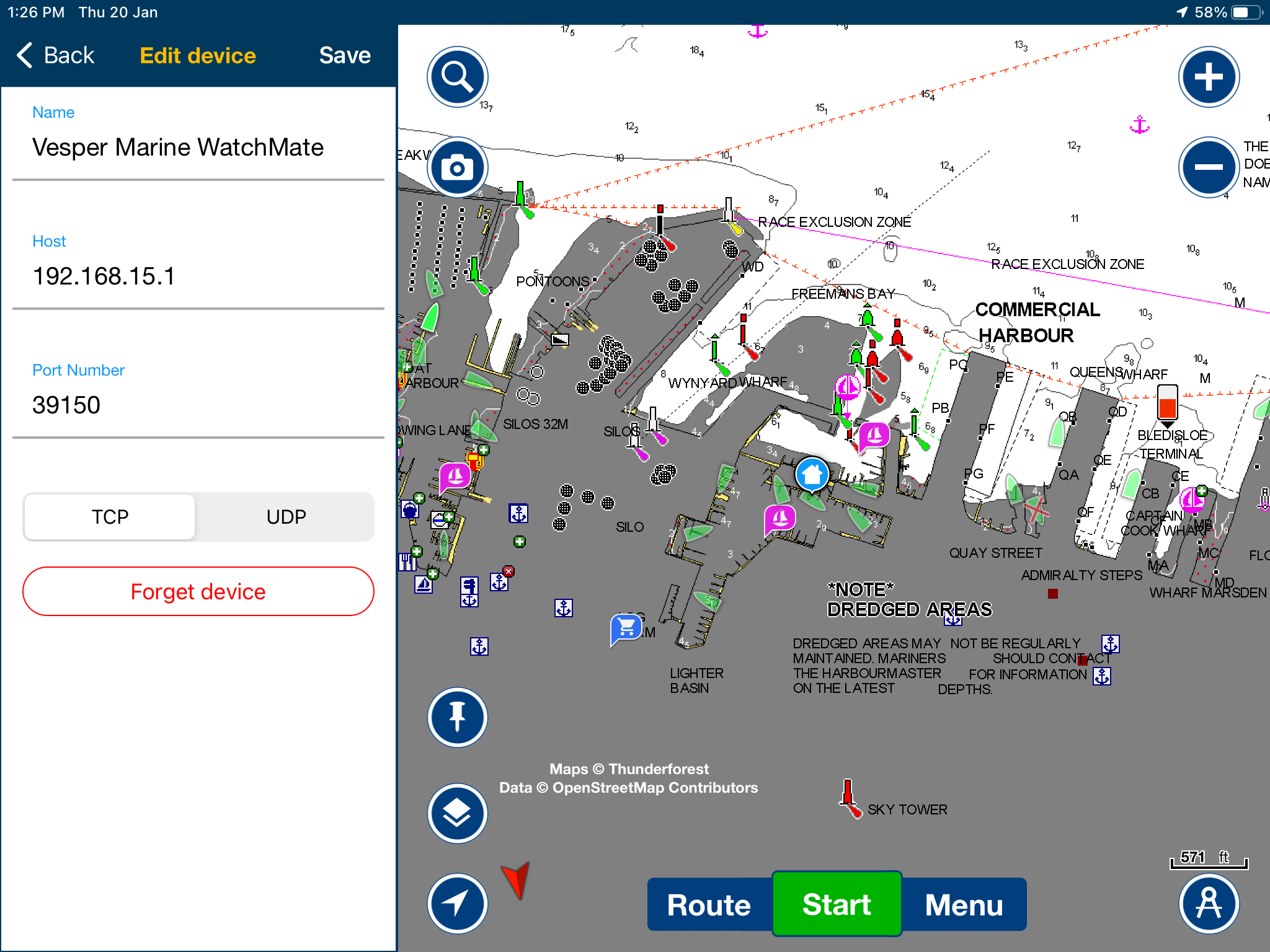

To confirm the source of the data:
Tap Menu on the Navionics App
Select Paired Devices
Select the Gear icon of the "Connected" device
This should result in the following page:
Name: Vesper Marine WatchMate
Host: 192.168.15.1
Port Number:39150
TCP is selected
