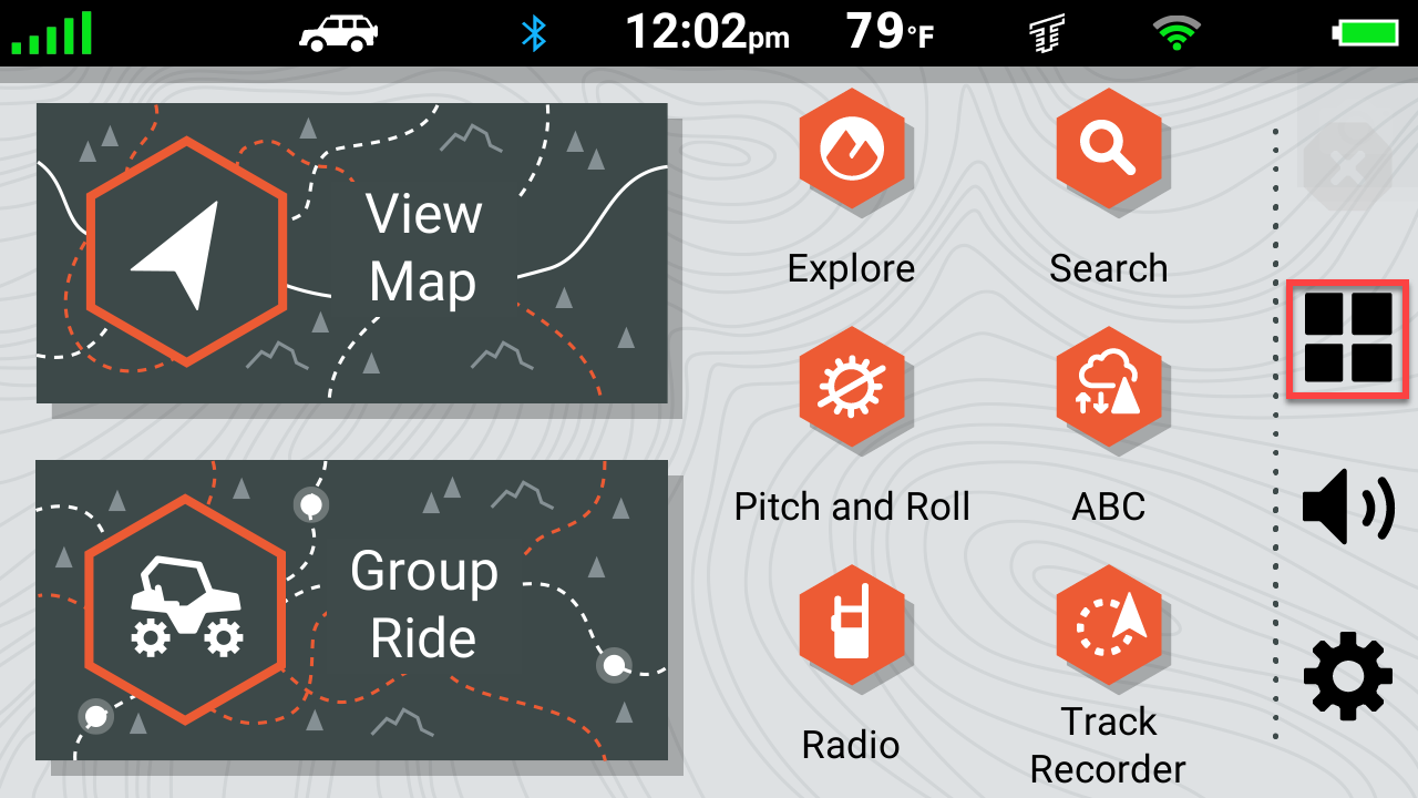

Tread® and Tread® - Base Edition GPS Navigators:

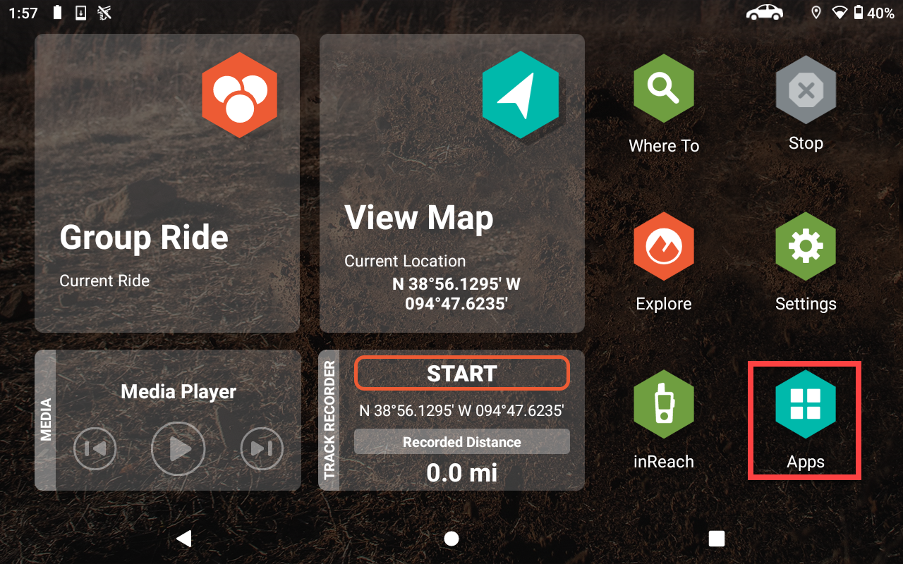

  1. Touch Apps
    Select Apps
  2. Touch Route Planner
    Select Route Planner

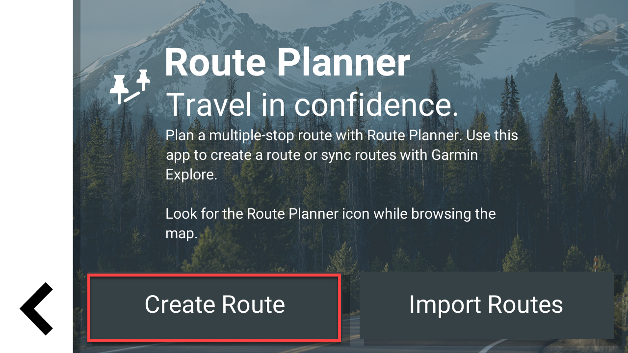

  3. Touch Create Route
    Create Route

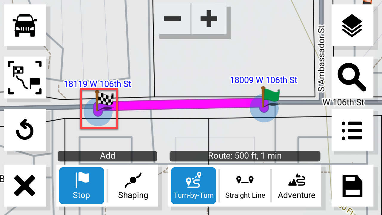

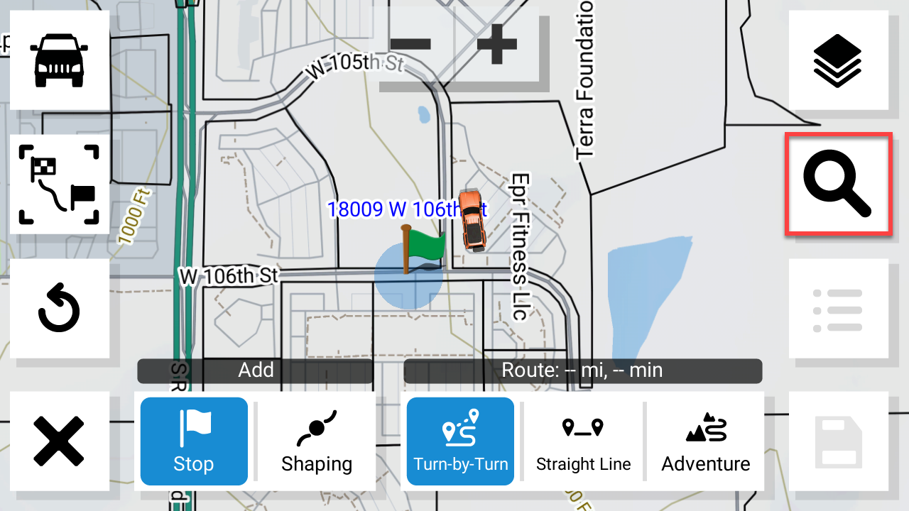

  4. Touch the map to add a start location or select the search icon  to search for a location
    Start Location
    • NOTE: The start location is the first stop on the route. You can use your current location as the starting location, but it isn't necessary. The device will skip your current location if that is where you are when it begins to navigate.
  5. Touch the map again to add additional stops
    Last stop
    • NOTE: The Turn-by-turn, Straight line, and adventure options on the bottom right will determine how the route is calculated by the unit when selecting locations on the map or searching locations to navigate to. You can change the calculation method anytime, and the next location you choose will then calculate based on that choice.

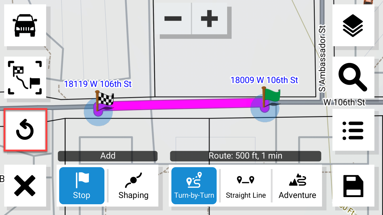

To remove the last selected location, touch the back arrow on the lower left to undo, if necessary.
Undo Icon Tread

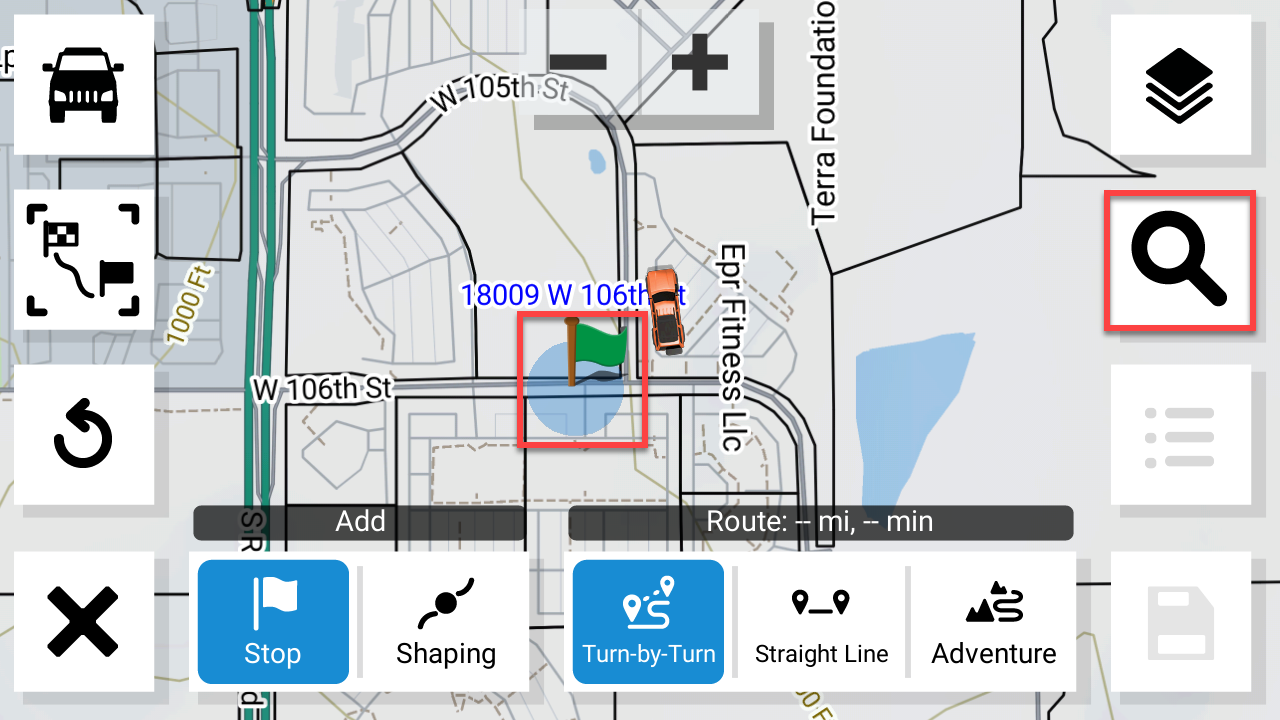

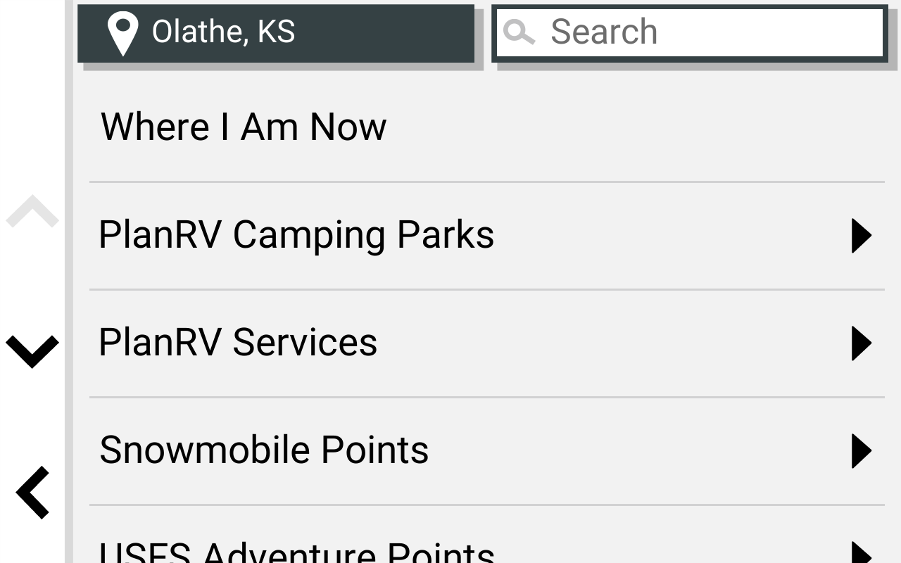

To Search for Stops by Using the Search Icon
  1. Touch the Search icon
    Search icon Tread

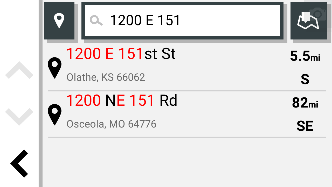

  2. Select the search method:
    Search options Tread
  3. Touch the correct location:
    Select a location

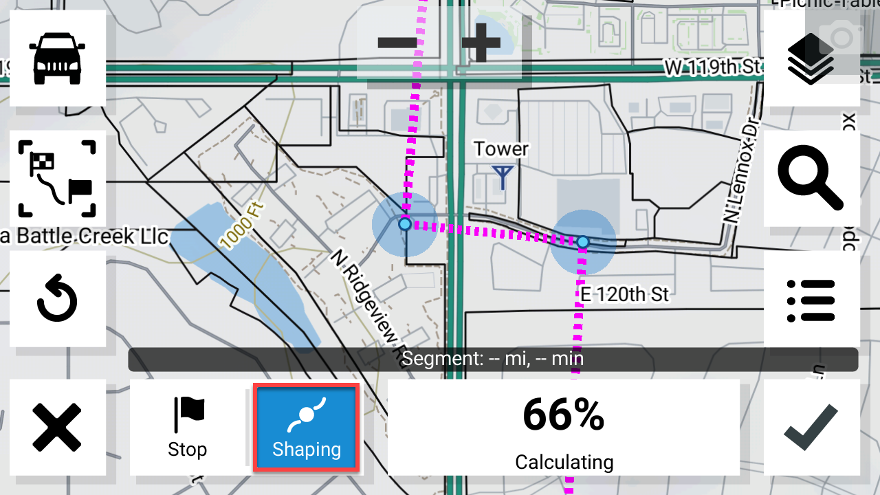

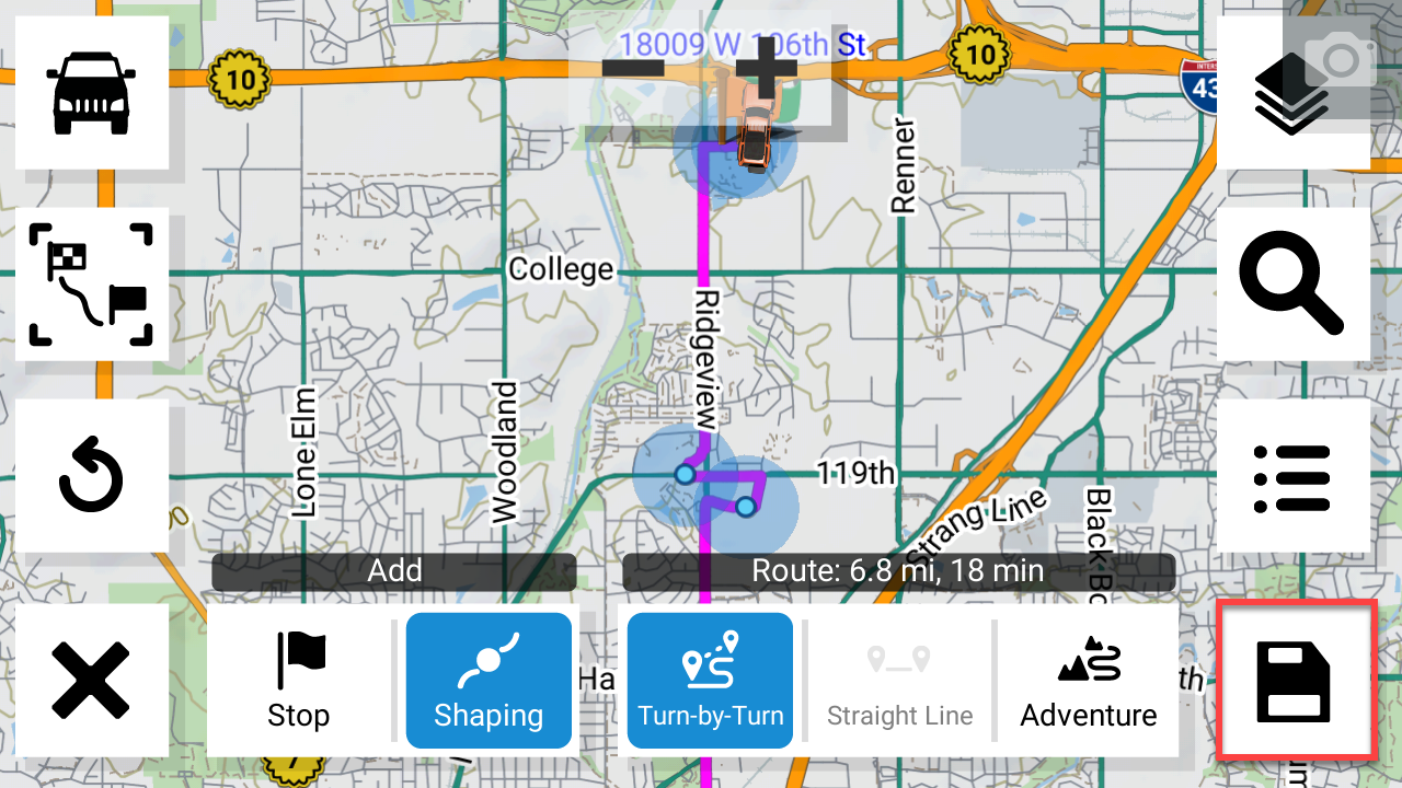

To Add Shaping Points
You can insert shaping points to change how the route navigates.

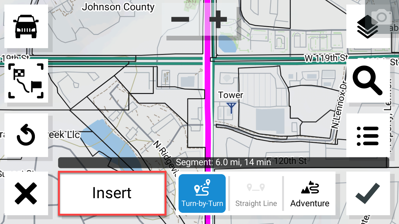

  1. Begin by selecting a route segment which is a section of the route between two locations, then touch Insert
    Insert shaping point Tread
  2. Select Shaping to select a location on the map to shape the route.
  • The device will calculate the route again with the shaping point you added.
Select shaping Tread

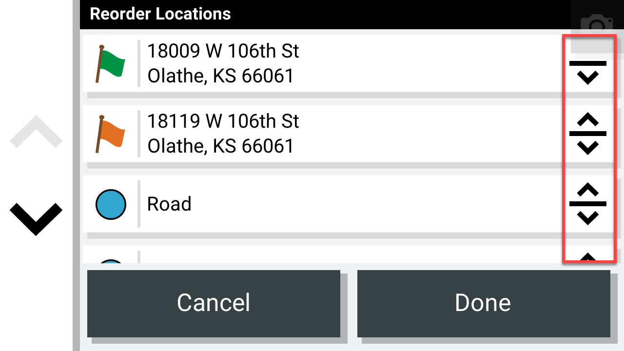

To Reorder the Locations on Your Route

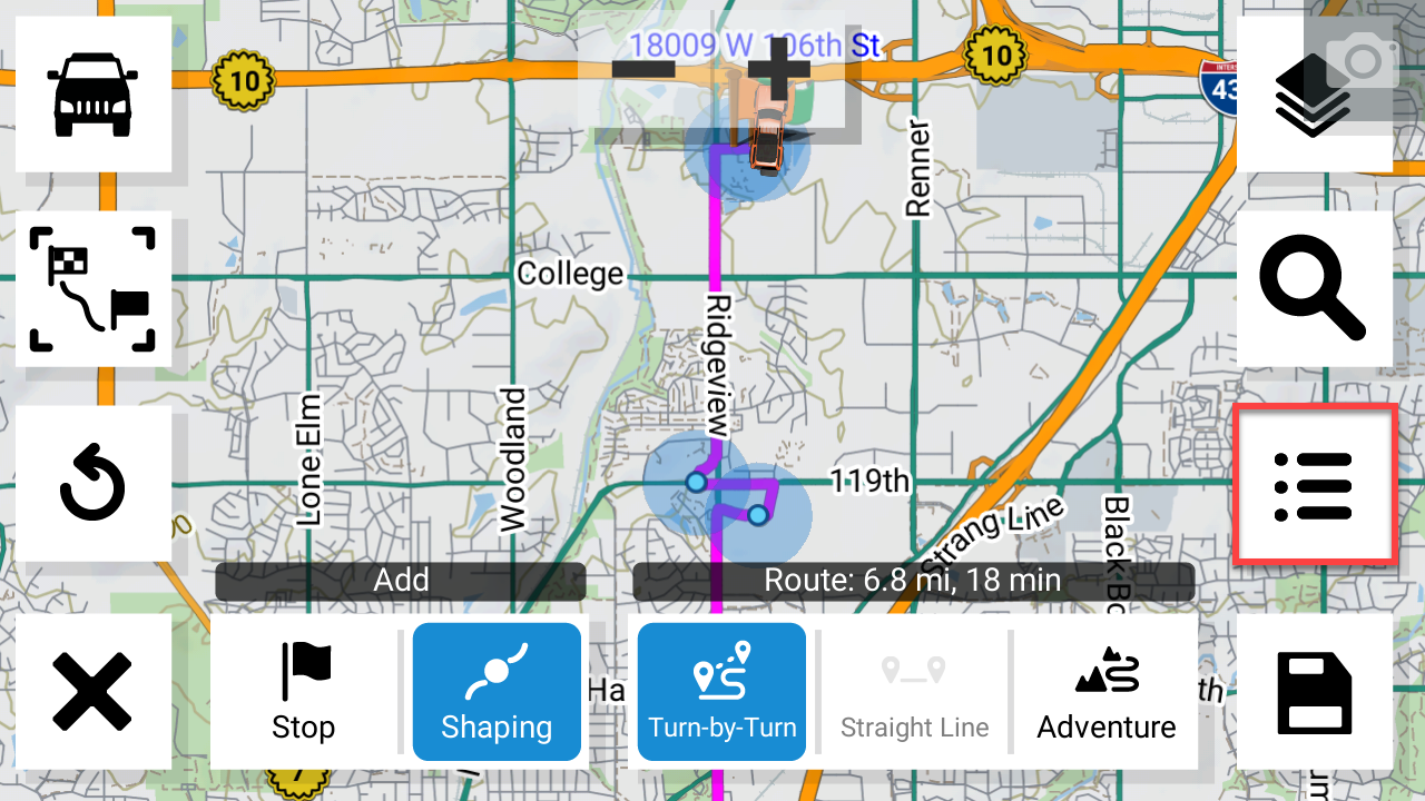

  1. Select the list icon in the top right
    List icon Tread
  2. Press and hold the arrow(s) on the right to drag the location in the desired order, then select Done
    Reorder locations Tread
  3. Once all the points on the route have been entered, select the Save icon to store the route on your device.
    Save icon Tread
    Enter the name of your route and then select Done to save it.

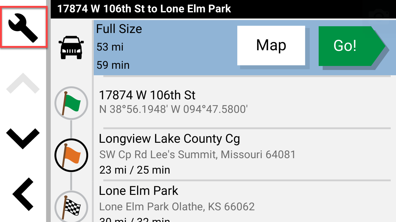

Edit a Route
  1. Touch Apps
    Touch Apps Tread
    Route Planner Tread

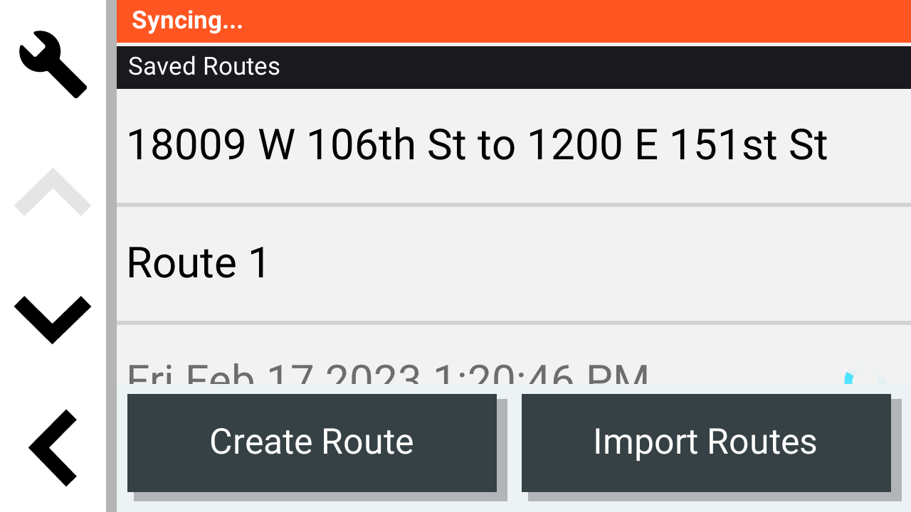

  3. Touch the saved route you would like to edit
    Saved Routes Tread

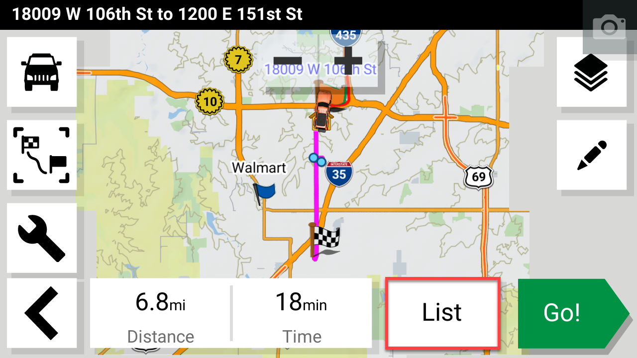

  4. Touch List
    Touch list icon Tread

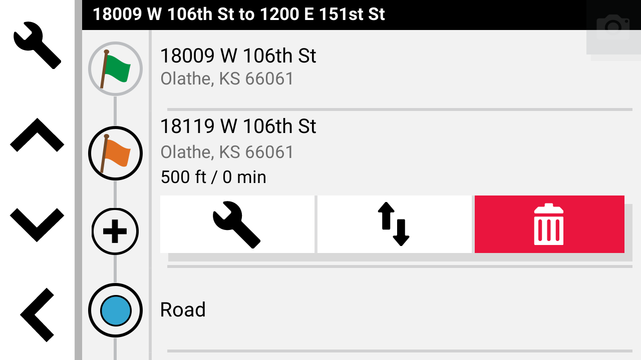

  5. Touch any waypoint or shaping point to show editing options
    Show Editing options Tread
Editing Options
    1. Touch the  add icon to add a stop between locations.
    2. Touch the  wrench icon to change a location.
    3. Touch to change the order of points.
      • Touch and hold the move icon next to a point and drag it to a location on the list.
        Move Icon tread

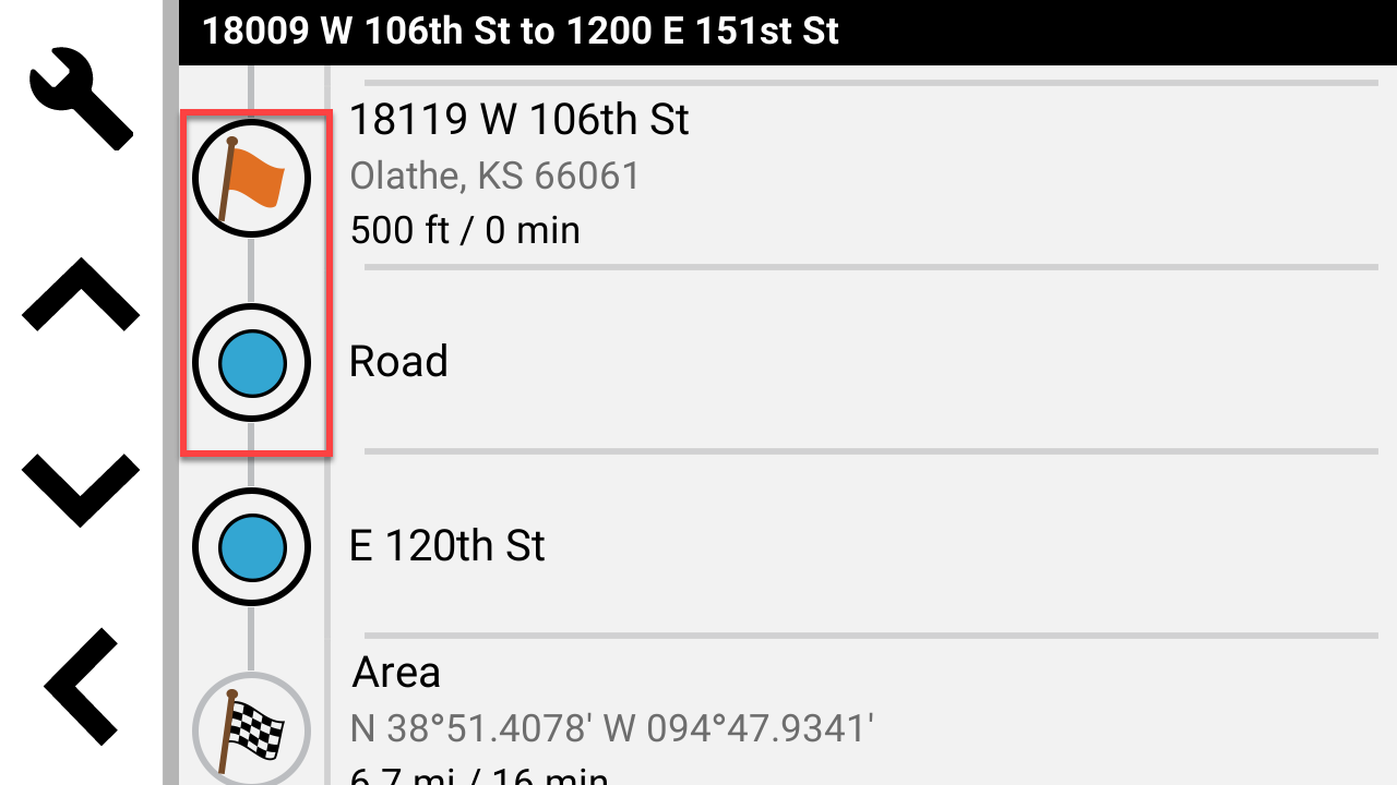

    4. Touch the  orange flag icon to convert a waypoint into a shaping point.
        • This builds a route passing through that point without navigating to it.
        • The icon will change to a  blue shaping point icon and the route will recalculate.

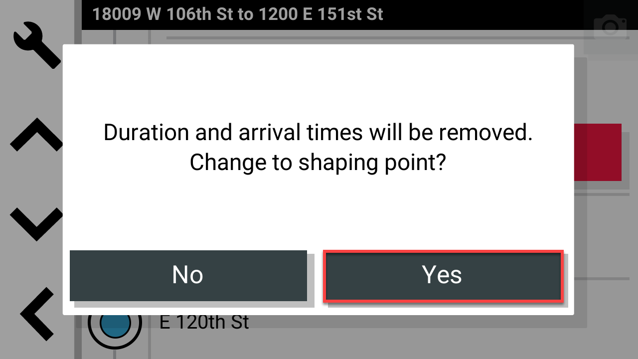

          Waypoints and Shaping Points
        • Touch Yes if prompted
          Change to Shaping Point

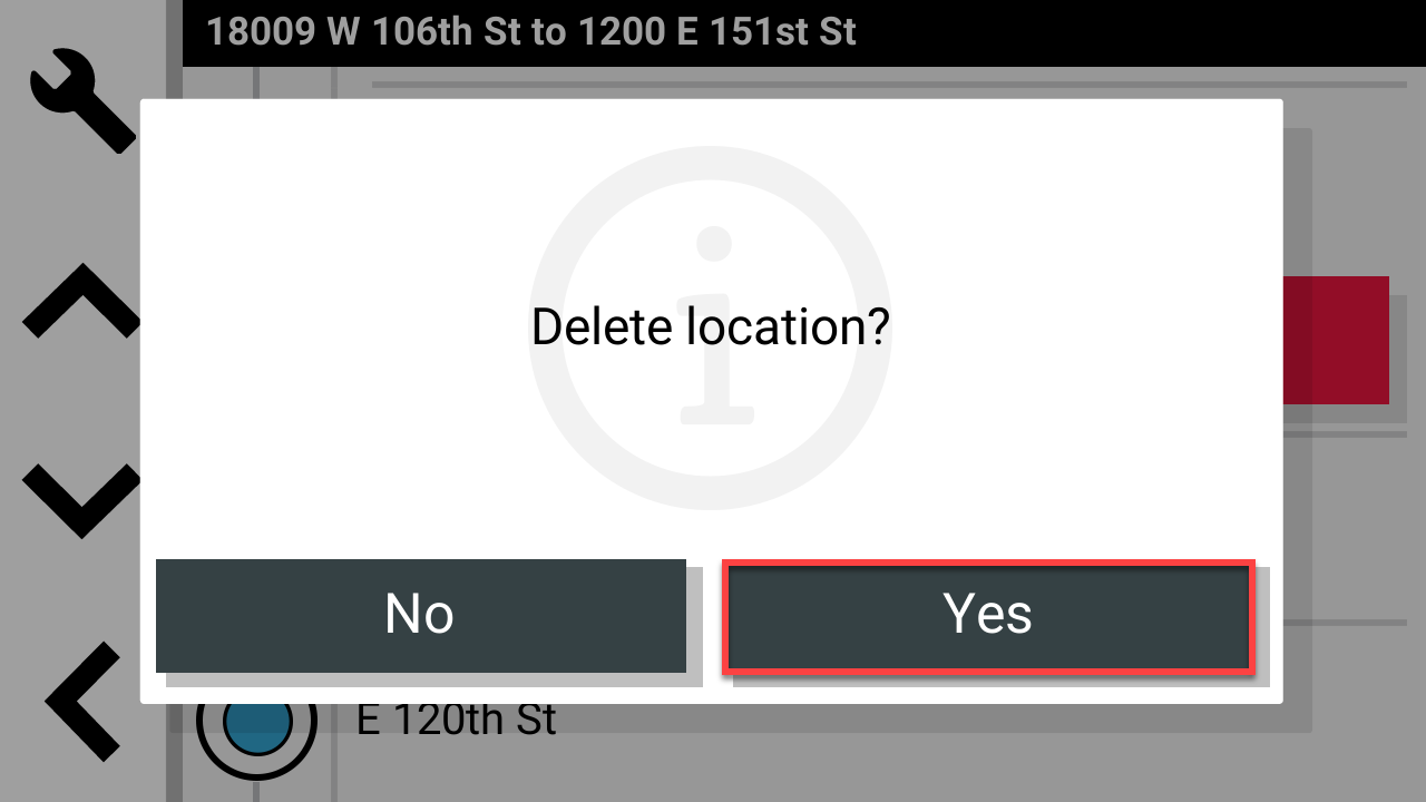

        • Touch the  delete icon to remove a point, then touch Yes
          Delete Location Tread
        • Touch the  wrench icon for additional route options.
          Wrench Icon Options Tread

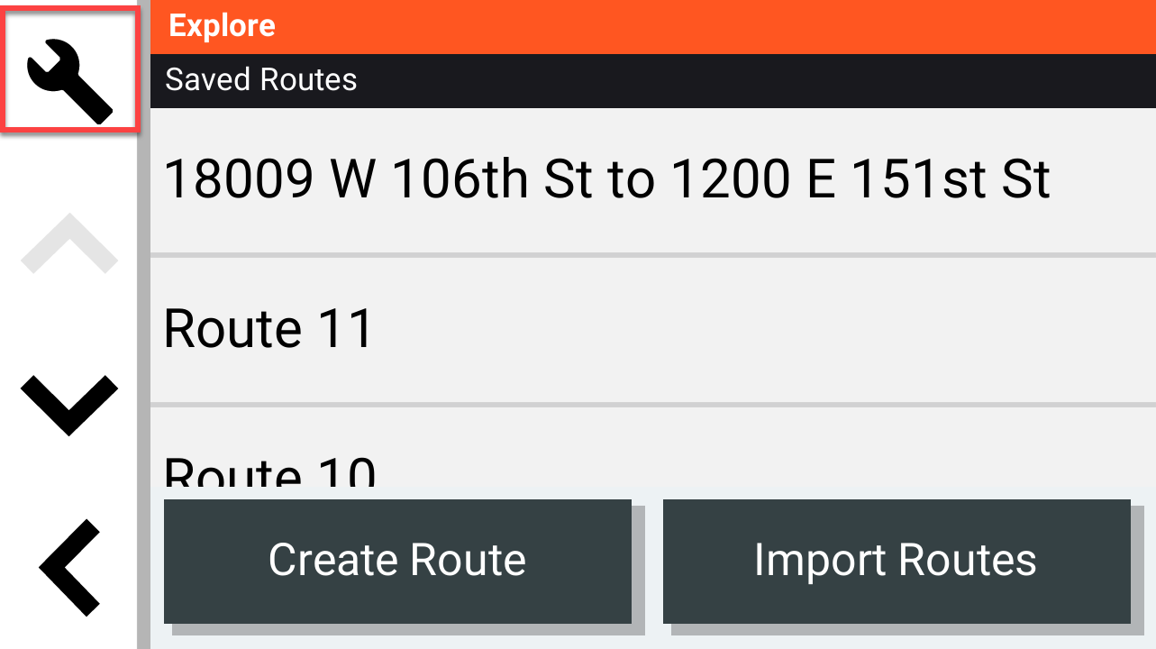

Delete Route(s)
  1. Touch Apps
    Touch Apps Tread
    Route Planner Tread

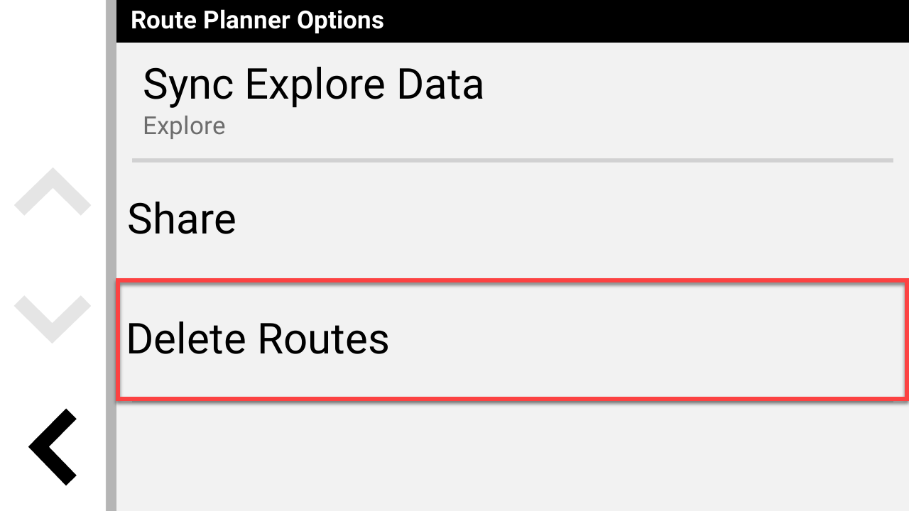

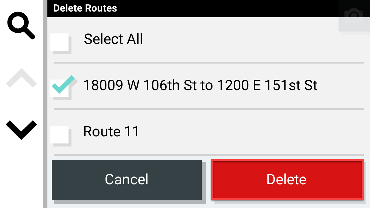

  3. Touch the  wrench icon to open Route Planner Options
    Select Wrench to Delete
  4. Select Delete Routes
    Delete Routes Tread
  5. Select the routes to delete and hit Delete when finished
    Choose and Delete routes Tread
  6. Select Yes
    Select yes to Delete Tread
    The selected route(s) will now be deleted.

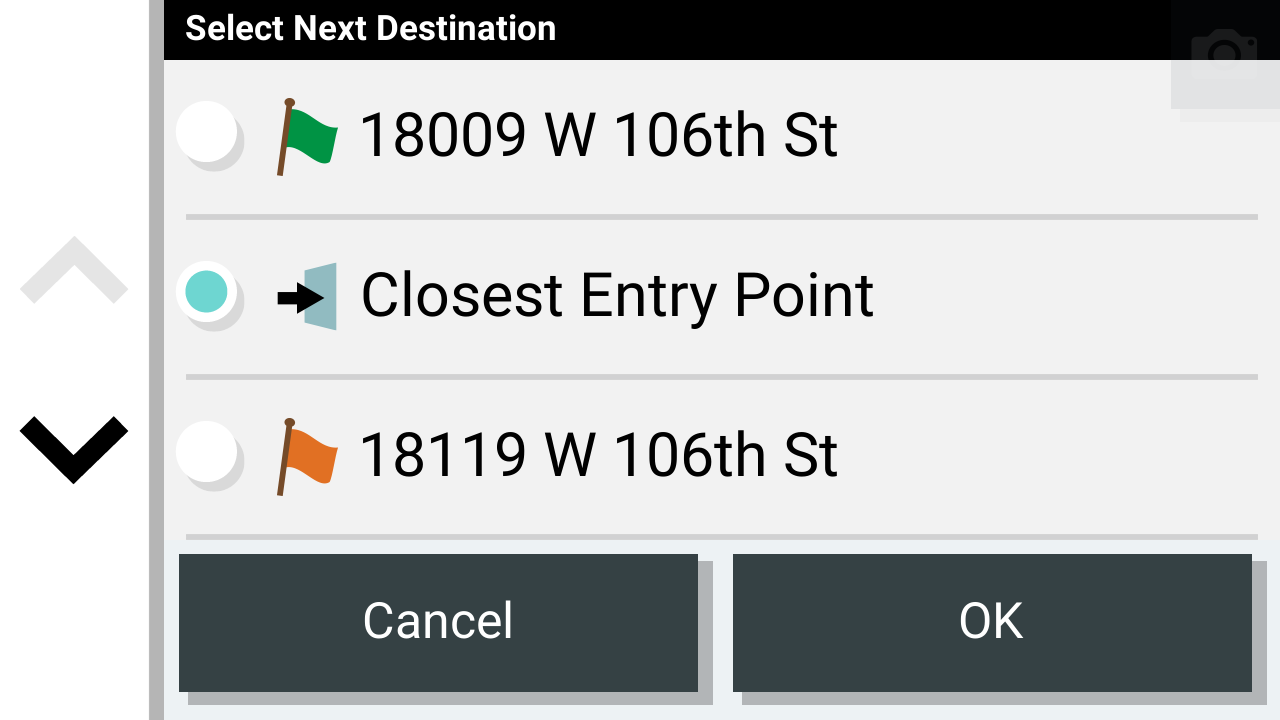

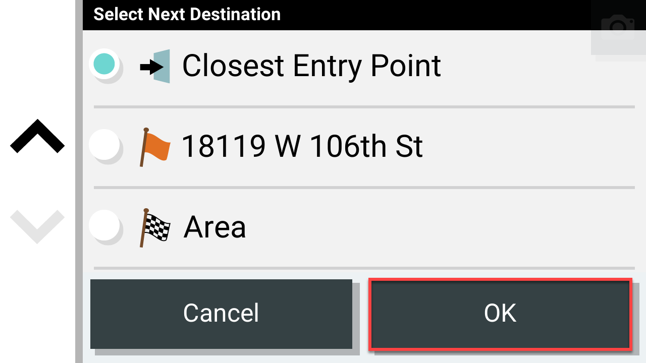

  5. Select the Next Destination of the Route
    • Select the Green Flag to route from your current location to the beginning of the route and then the full trip.
    • Select the Orange Flag to skip the starting location and route from your current location to the waypoint selected in the route and then the remaining trip destinations in order.
    • Select the Checkered Flag to route from your current location skipping all the points in the route and taking you the quickest way to the destination point.
    • Select the Closest Entry Point to skip the starting location and calculate the quickest way to get on the planned route.
Route destinations Tread
6. Touch OK
Touch OK to select destination Tread

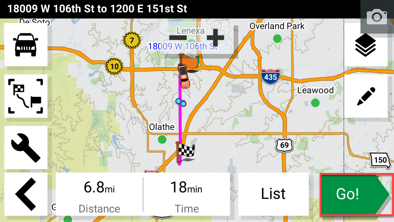

7. Touch Start

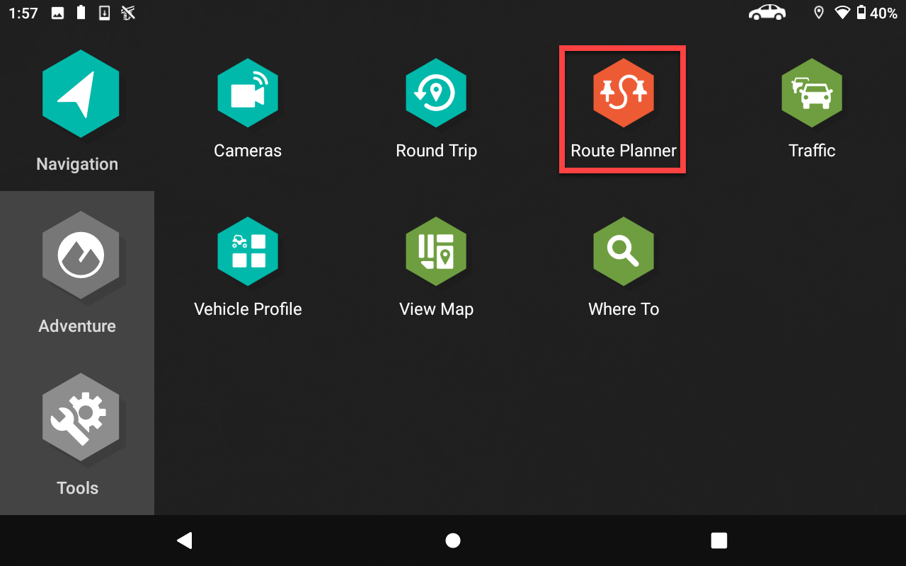

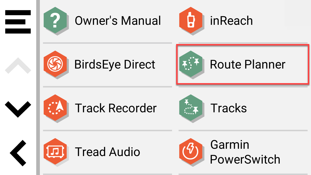

  1. Touch Apps
    Select apps tread
    Trip planner tread
    • On some devices, Route planner is on the main menu as well.
    Start Location
    Last stop
Undo Icon Tread

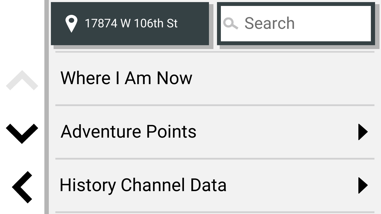

    Search icon Tread
    Search options Tread Android
    Select a location
Use the map or search options to select additional locations on the route.
    List icon Tread
    Save icon Tread
Edit a Route
  1. Touch Apps
    Select apps tread
    Trip planner tread
    Saved Routes Tread
  4. Touch List
Editing Options
        Move Icon tread

Delete Route(s)
  1. Touch Apps
    Select apps tread
    Trip planner tread
    Delete Routes Tread

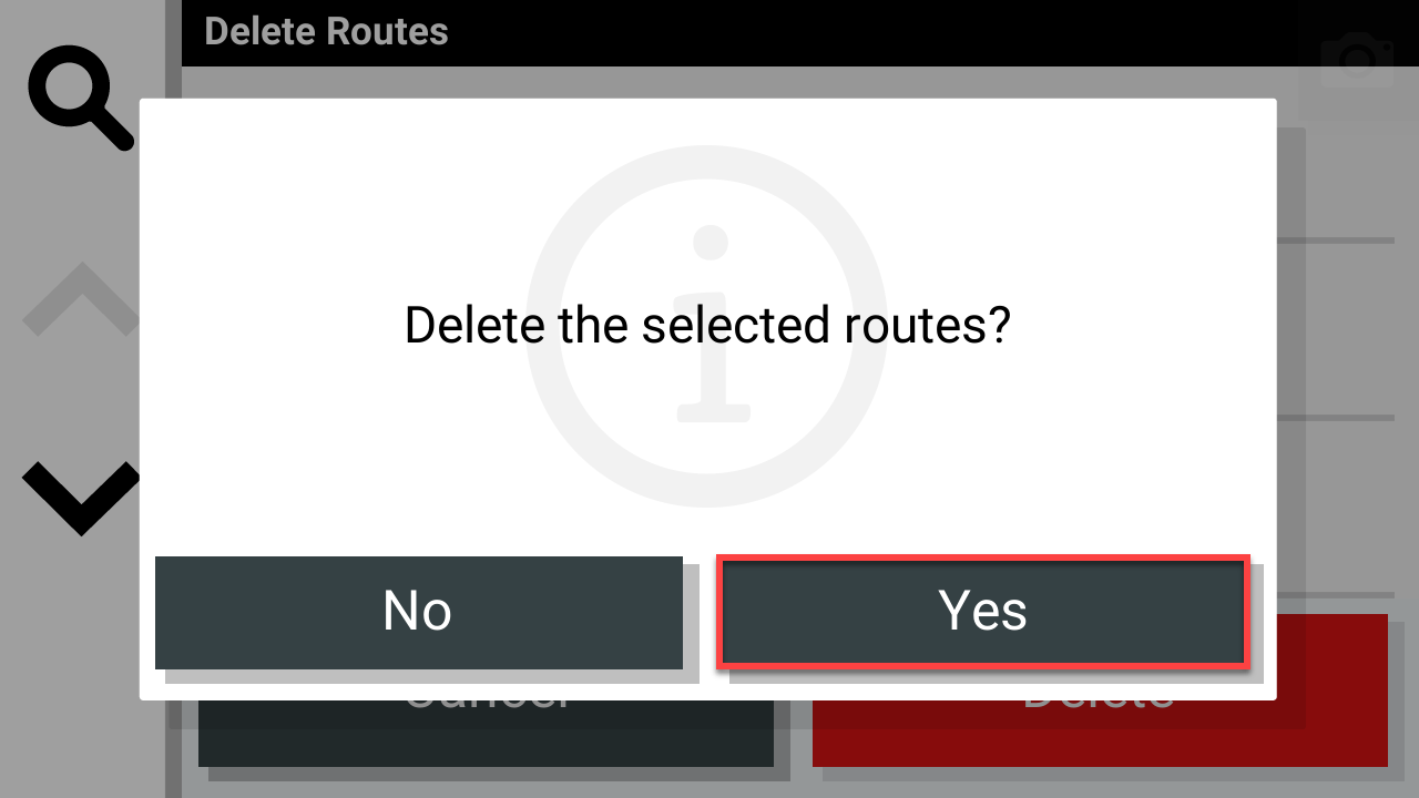

  6. Select Yes

  4. Touch Go
6. Touch OK
