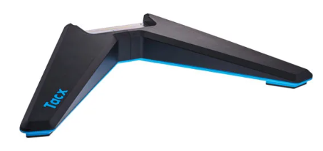

  • Trainer Legs

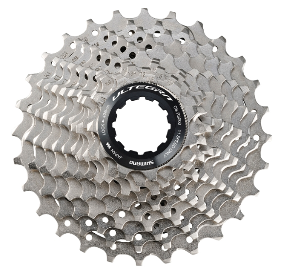

  • Cassette

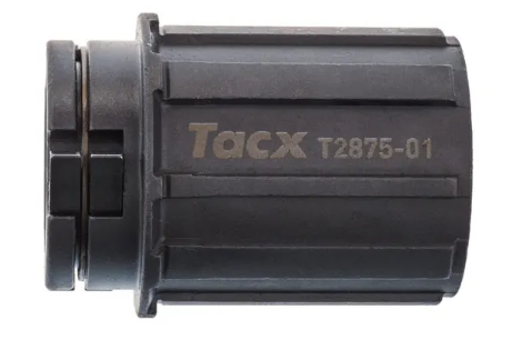

  • Freehub Body

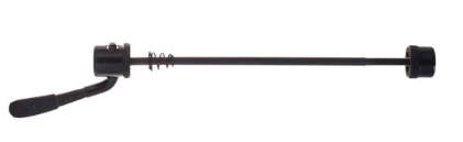

  • Quick Release

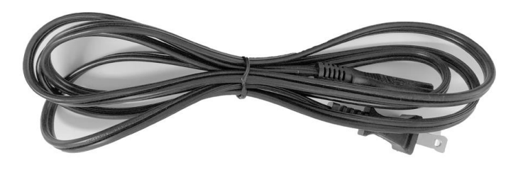

  • Power Cable
