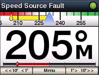

Speed Fault Message
This warning is sent from the CCU every 15 seconds while it detects a speed source issue while the autopilot is engaged. Often this warning is noticeable, but not so repeatedly that it renders the autopilot title banner useless. The display will blink the white text for 5 seconds, and then there will be 10 seconds of the standard green text before the white text displays again.
