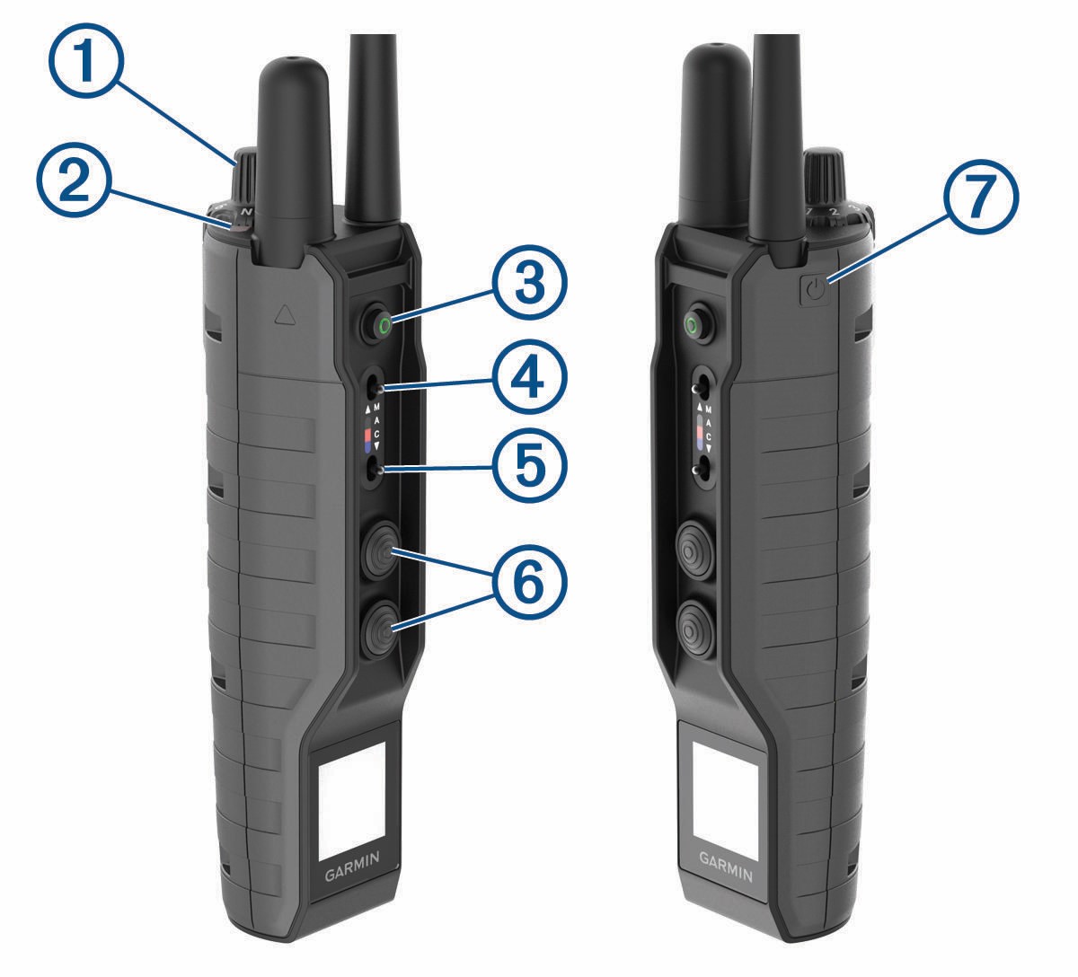

Pro 550 Plus Button Layout
pro550pluslayout
1Intensity level and training mode dial.
2Battery level indicator
3Tone Key and Select Key
4Dog collar toggle switch
5Mode toggle switch
6Training Keys and Scroll Buttons
7Power Key and Ability to view Marked Truck Location
