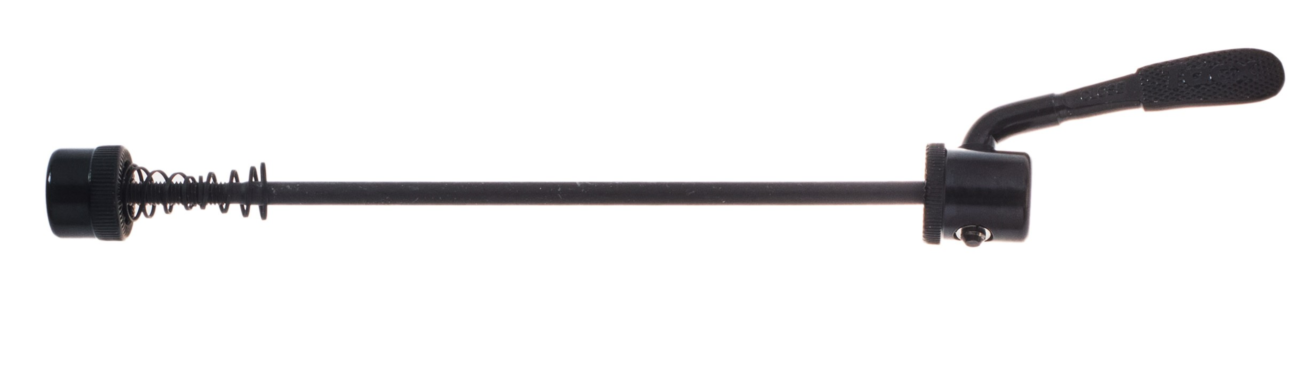

130mm Quick Release
No additional set up needed. The trainer is set up for bikes with 130mm spacing out of the box. After placing your bike on the trainer, use the included Tacx Universal quick release skewer to fasten.
Tacx 130mm quick release skewer with check mark. Thru-axle crossed out.

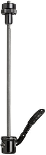

  7. Install the included Tacx quick release skewer for thru-axle bikes (the longer of the two quick release skewers) to fasten your bike to the trainer and start training!
    Tacx thru axle skewer with check mark. 130mm QR crossed out.

  4. Place your bike on your trainer and install the Tacx Universal quick release skewer to fasten and start training!

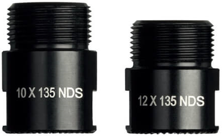

  3. Install the 10x135 or 12x135 non-drive side end cap depending on your bike's rear axle diameter.
    Type 2 thru axle 10x135 and 12x135 NDS adapters
  4. Place your bike on the trainer and install your bike's rear thru axle to fasten and start training!

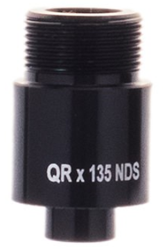

135mm Quick Release
If your bike features a 135mm rear quick release axle, use the included 135mm quick release end cap (QR x 135 NDS pictured below).
QR x 135mm non-drive side for Type 2 trainer
  1. Remove the QR x 130 NDS (non-drive side) end cap pre-installed on your FLUX trainer. Do not remove the DS (Drive Side) end cap.
    QR x 130mm non-drive side for Type 2 trainer Photo of Tacx NEO 2T with arrows pointing to the drive side and non-drive side
  2. Replace the QR x130 NDS end cap with the QR x 135 NDS end cap.
  3. Place your bike on your trainer and install the Tacx Universal quick release skewer to fasten and start training!
