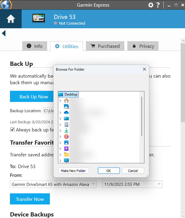

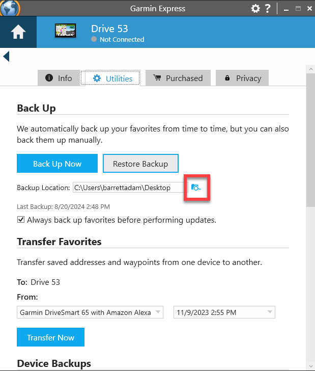

To Change the File Location Where Backup Locations are Saved
  1. Open Garmin Express softwareGarmin Logo
  2. Select your device
  3. Click Tools & Content
  4. Click the Utilities tab
  5. Click the Folder icon
  6. Select a new backup location. Folders and locations can be expanded to select sub-folders. Click Make New Folder to create a new folder inside of the currently highlighted selection, if desired.
  7. Click OK
The Backup Location will now be changed.

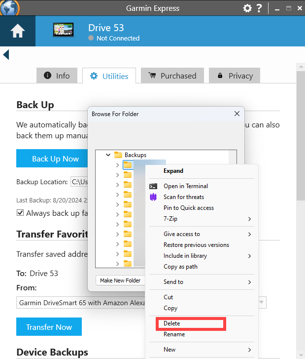

To Delete Backup File Locations
  6. Right-click on a backup folder or file, and click Delete.
